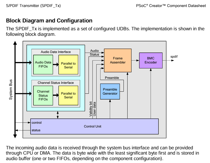

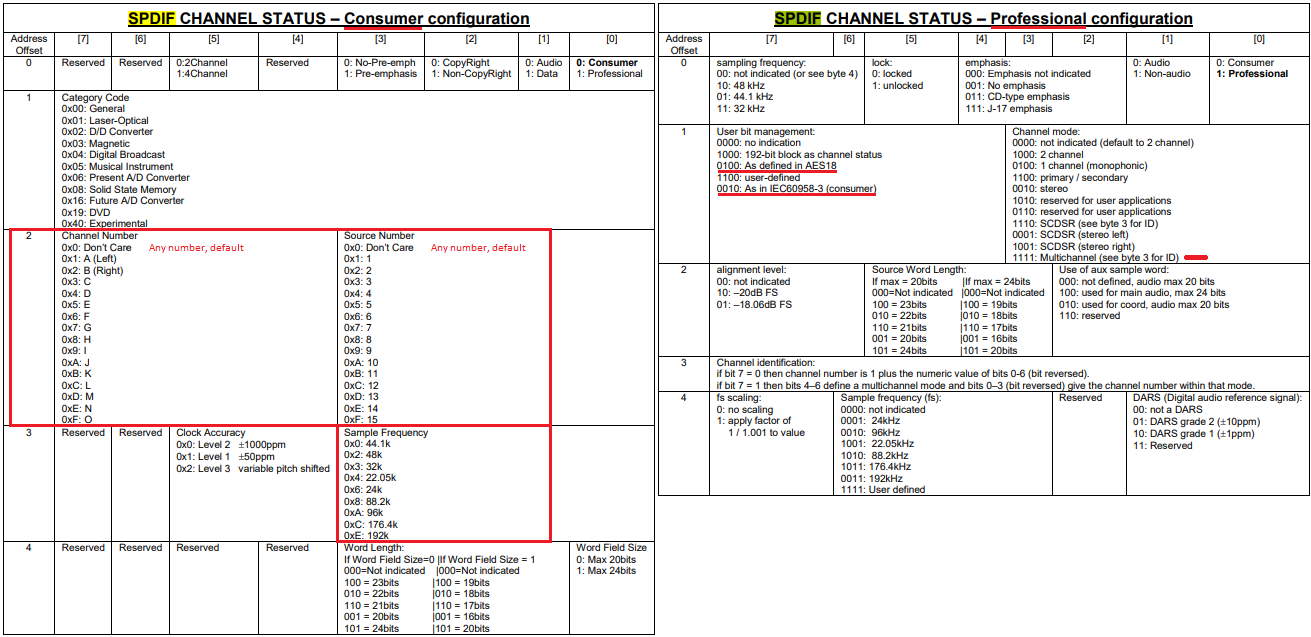

All those digital formats are just compressed PCM, no different to 7-Zip or WinRAR, companies can call their tech whatever they like.
Also a good reason to stop using MP3, its lossy compression, imagine this driver with 'lossy' compression, lol.
Its also the same thing with analogue, no analogue system is lossless, even an analogue CPU is inaccurate.
Bit-perfect FLAC or don't bother :)
With upgraded SPDIF - TOSLink and a DMAS (digitally managed audio system), compression is optional, PCM is standard.
In this case the digital device (1st), can decode compression back to PCM.
RTN digital transmission is real-time bit-perfect (bitstream).

Now lets say you had the current consumer standard (updated) SPDIF, which is 15+ channels, it can set the 8 x 16b 192k PCM stream needed to bitstream (passthrough).
The legacy SPDIF, still used at this time, but now superseded by the current version, uses only a 2 channel transmitter, and can not set as 8.

52 x 48b 48k = 119.8 Mbit/s, TOSLink high-speed modules: 125 Mbit/s (NRZ-PAM2). BMC is bitrate heavy (and old), RTN is bitrate light.
102 x 24b 48k = [117.5 Mbit/s] | BMC: [235 Mbit/s] required, RTN: [123.3 Mbit/s] required, RTN fits in [125 Mbit/s].
CPU/RAM (Device) > SPDIF (RTN) > TOSLink (125) -- TOSLink (125) > SPDIF (RTN) > CPU/RAM (DMAS).

Note, in the event Realtek update SPDIF to current consumer, and some Windows updates, DTS would support 15+ channels (12, any).
In the event of the update, you will be able to passthrough all formats, up to 62.5 Mbits/s BMC (125 Mbits/s TOSLink).
The will be a new model (if any), since the current ALC's have 2 channel transmitters/receivers (hardware).
