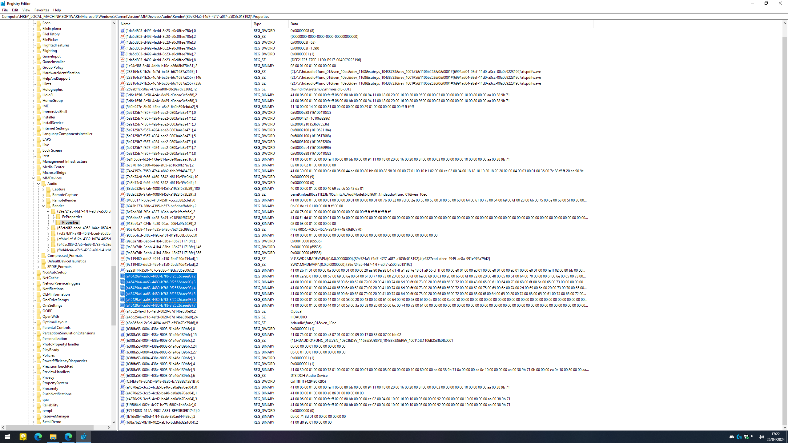

If you need to reset DTS and clear spatial data for any reason (Windows updates, other) do the following:
1: Open 'Services', then double click and disable 'Windows Audio', 'Endpoint Builder', and the extra 'Realtek Service' task in 'Task Manager', then restart your computer.
2: Open 'Regedit' and go to [ HKEY_LOCAL_MACHINE\SOFTWARE\DTS\APO ], and delete all the endpoint entries, but not the 'APO' key.
3: Go to [ HKEY_LOCAL_MACHINE\SOFTWARE\Microsoft\Windows\CurrentVersion\MMDevices\Audio\Render ], go through each device doing the following:
> Hold shift and select all [ {a45429a4-aa63-4480-b7f8-3f2552daee93} ] entries, 2 to 6-7, then delete them (not holding shift).
4: Open 'Services' and 'Task Manager' then enable the disabled services and task, restart your computer.
Note with 'Regedit' you can copy the above locations into the navigation bar at the top.

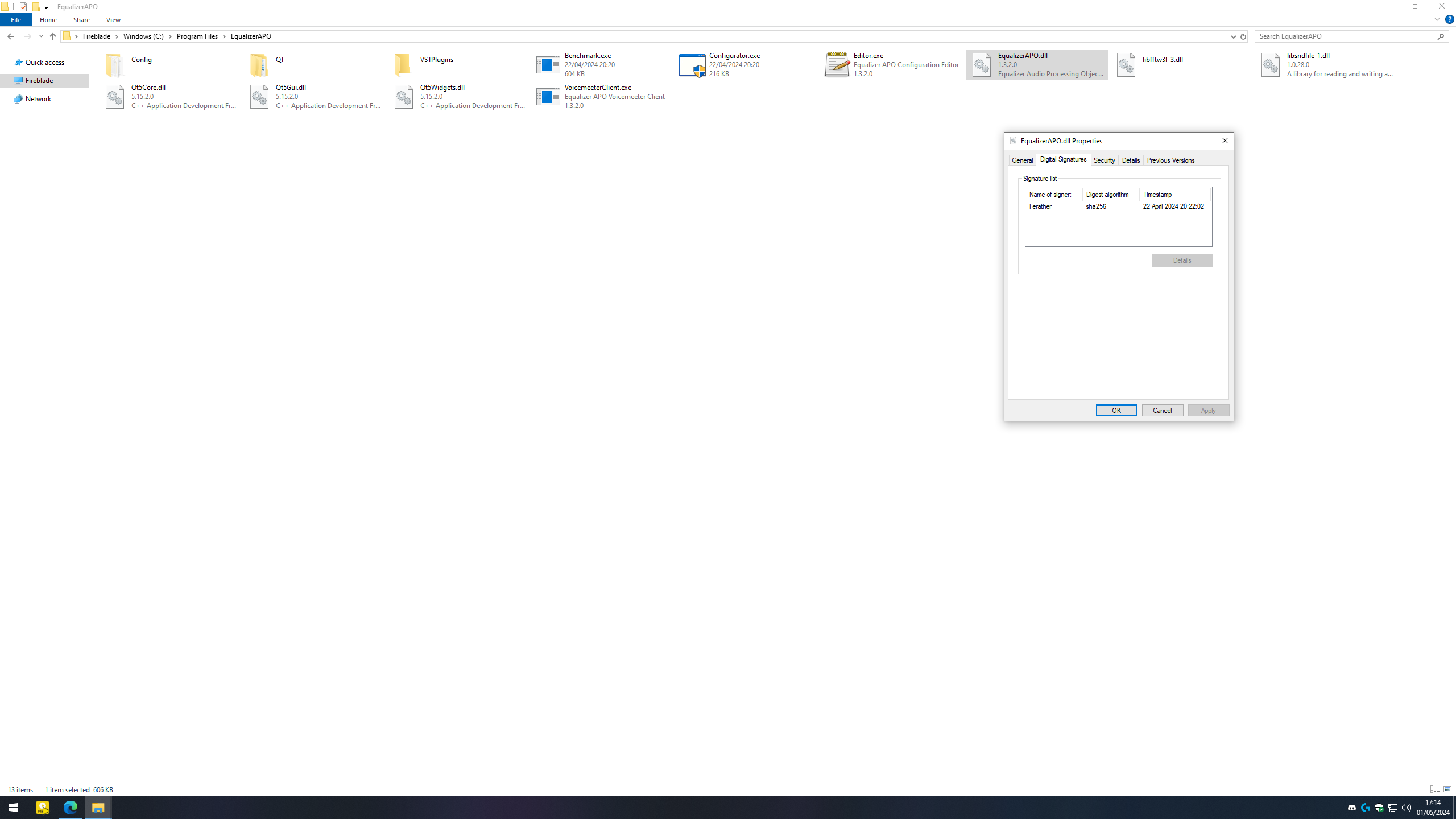

If you are using Equalizer APO, the latest version is 1.3.2. If you are using an older version and my upmixer, install the update then re-run 'Configure.reg', reboot.

Some notes with Equalizer APO (I will contact the author at some point). It has a bug at least with optical endpoints with an encoder, set to passthrough.
The passthrough key specifies [2 channels 16 bit 48k], which is the PCM stream used to transmit DTS-Dolby on SPDIF interfaces.
Please note a stream, can have specifications (PCM, 16bit 48k), but be empty of audio, or contain something else.
By default Equalizer APO detects the end format key (2ch 16/48), but also the format used in the engine (6ch 24/48), and likely gets confused at times.
With its default flags (13) some apps would cut out, on load or minimise to desktop, my edit fixes this issue (last I checked).
The are however two remaining EAPO bugs, 1: An occasional device start-up cut out, 2: Can have a fit cutting out when muted/unmuted.
The start-up cut out is fairly rare, maybe 1/20, but also random, so maybe 1/5, but causes no runtime issues.
I don't use mute much but when I do, it tends not to happen, but if tested (repeated) it will eventually happen (maybe first time).
It would seem EAPO does not cut out the stream, as other MFX-EFX points do not re-initialize, but instead cuts out the content.
Note sure why it reacts to mute other than the passthrough format, as mute is after EFX (to my knowledge).
Testing mute, I can see the audio meter still going up-down, and APO's do not re-initialize.
No known issues without Equalizer APO.
@Ferather I'm a little bit confused right now.
Can you please explain this in more detail for me? I have noticed that this nonsense is sporadically entered in the registry:
Also the DTS APO part on your third screenshot: Is what we see on the screenshot okay and should be entered exactly as it is, or are you demonstrating an error situation?
It also looks messed up in my registration:
I'm toying with the idea of revoking the write permissions of the AudioEndpointBuilder and/or the AudioSrv as well as the system user as TrustedInstaller for specific Reg-Keys. The behavior of Windows is once again just annoying.
Thanks in advance!

@leveltrauma
Question 1: That I modified, as I was debugging E-APO and the weird issue it has. E-APO only supports single line (I call exclusive) APO's and does not support multi-line (composite) APO's.
The keys with the data [!VALUE] pertain to adding another APO for E-APO to support (support currently installed APO), which again is read from exclusive not composite.
Realtek has not used exclusive, single line, APO entries for a very long time, and in order to get more than one active APO system, composite is used.
I deleted the entries in E-APO's registry point purely for debugging, with the data [!VALUE], they are already inactive.
Question 2: This one is for developers to follow, by default they should already understand the information given about APO initialization, DTS outputs a count to follow.
In a way the screenshot can be used as a reference, if only the mode (APO-Music) line is present (after a reboot), then DTS-APO is not running.
This means you have installed the main option, and will need to fully uninstall it and swap to alternative, then it will work.
DTS will create all keys and data by its self, there is no need to edit-modify anything.

Hi, i just upgraded to the last drivers, and all went perfect, but i was doing some test and just install and old file DTS-X Ultra.7z from your thread, after this, nothing sounds in my system, when i go to do the windows sounds tests, it says, cant play the test sound in that device :( How can i uninstall that DTS-X utlra? Thanks
I just saw that cant start DTS APO Service, giving that error when i try manually...
Apr 24, 2021
38 (0.03/day)
View attachment 349558View attachment 349559
If the service couldn't start, please check in [HKEY_LOCAL_MACHINE\SYSTEM\CurrentControlSet\Services\DtsApo4Service]
the content of the ImagePath.
for i.e.:

@Axel_Moore, You are missing the library's, I noticed that with W11, In the 'UWP Apps folder', install then reboot, the service will start as normal.
@leveltrauma
You don't need to do do anything specific to the registry or anywhere else. The only thing I do is remove the 'Listen To' code that is added either by Windows or AMD.
Other than that there is no reason to try and copy older screenshots. There is nothing you can do to improve audio quality after 'Win CAudio'.
Microsoft has made changes since those last screenshots. And I am sure its AMD that adds the 'listen to' code to endpoints.
