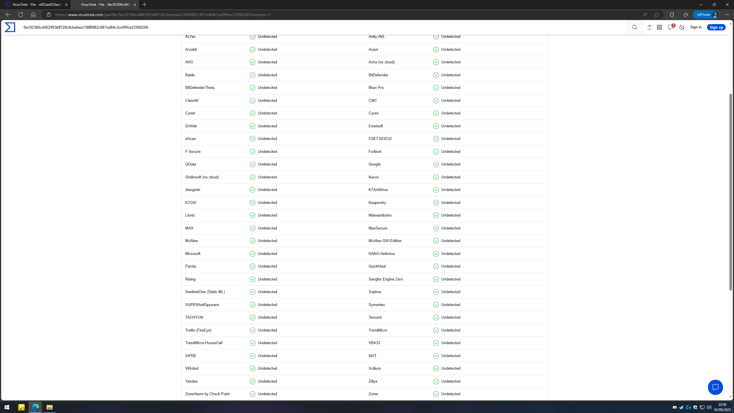

For some reason the 'AutoHotkey.exe' is not flagged with this pack, regardless, its a false positive if you get it. Enjoy!
