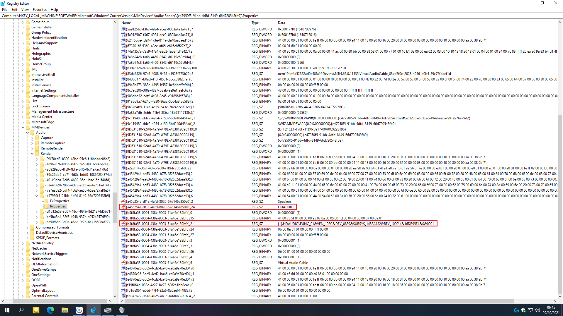

How to convert a device to HD Audio (and unlock Ultra).
In this example, I am using a virtual device, but for devices that still don't work after you have done the setup .reg, such as USB, do the following:
Open 'FX Config' and select the device you want, then on the right press the 'Jump to Properties Key', this will open 'Regedit' at the device.
Find a 'HDAUDIO' device on the system (left side in Regedit), it can be anything that says 'HDAUDIO', I used Realtek 'Speakers'.
Find and copy the value of '{b3f8fa53-0004-438e-9003-51a46e139bfc},2', replace the value on the virtual device (USB).
Next, replace '{a45c254e-df1c-4efd-8020-67d146a850e0},24', with 'HDAUDIO', no '', then restart your PC.
