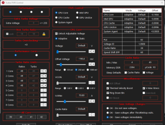

Encountered weird behaviour while undervolting my i7-8665U
May 22, 2023
20 (0.03/day)
System Name Dell Latitude 5500
Processor i7-8665U
Benchmark Scores Cinebench R23 (Multi-core) : 4534
So I have been using Throttlestop for undervolting for a while now since its so much better than XTU (and latest versions don't even support my processor).
Since past 6 months, I had been using Throttlestop since Dell has provided such an ineffective cooler with the Latitude 5500, that it used to thermal throttle at almost anything.
Earlier I just used to disable the Turbo Boost, but then the laptop performance just drops significantly.
Thankfully, undervolting had made my thermals and package power usage much better and its definitely a lot better now.
Since past 6 months, this has been my voltage offsets.
Earlier just going above -110mV on both made my system unstable and TS Bench would show errors, so I never bothered tweaking more since I was more than satisfied.
But past week I finally tweaked it more. I found out that if I reduced the cache offset from -110mV to just -100mV, the core can go upto -190mV while still remaning 100% fully stable.
This behaviour is something I haven't seen anywhere before.
So is this normal and should be expected?
Also is having such a big difference between core and cache voltage offsets normal?
Using different offset voltages was popular with 8750H and 9750H processors. I just did a write up this morning in a different thread that explains what is likely happening.
The bottom line is that if you get better performance or better temperatures by using different voltages then continue using different voltages. Use Cinebench R23 when testing your results.
Yes. Whatever works best is normal. You will reach a certain point where going any further with the core offset will be ignored by the CPU. You can probably adjust the core slider to -1000 mV. You might still be 100% stable because most of that difference is being ignored by the CPU. Most owners of U series processors have never tested using different voltages.

So I was experimenting with a few more settings. I raised my PL1 from 28 to 45 and PL2 from 51 to 60. Also time was increased from 28 to 640.
However the cinebench R23 score dropped. And it isn't a small drop, it is a drop of more than 200 points.
Note that before this change, there were many more power limits appearing in the Limits tab. PL2 isn't even reached, as max draw was about 50W.
unclewebb
Jun 1, 2008
8,347 (1.35/day)
You have to check the MMIO Lock box. Your MMIO power limit is set lower than the MSR power limit. Increasing the MSR limits will be ignored when the MMIO limits are lower. The lowest power limit wins control of the CPU. It is easier to manage only the MSR limits. The MMIO Lock box disables the secondary power limits.
No need to increase the turbo time limit to 640 seconds. Do you really need more than 10 minutes of turbo boost? Your laptop cooling system cannot handle that. The default 28 seconds is more than enough turbo time.
Try setting Power Limit 4 to a value of 0.
Your CPU does not support overclocking. You can set the turbo ratios back to the default values that are listed. U series CPUs do not support an all core overclock.

So I ran some tests and finally found some success.
Firstly I had reduced the turbo time to 28.
As you can see Max power draw was 50.5 W. Score did increase, but still not to the level it was earlier. (4139 vs 4343 (earlier))
But then I spotted that for some weird reason, MMIO wasn't locked (I swear I had ticked that thing), so I just locked it and re-ran Cinebench R23.
And it worked, now got a score of 4506 vs 4343, which was previous best. So that MMIO lock thing did work.
I also figured out what the lock does, it basically ensures that the manually set value will be locked when shut down/restart etc.
After the second test (the one in which score was 4506, sorry I don't have screenshots for it), the max power draw was 49.9W. Also the in the Limits tab, everything was same as the one in the screenshot, except BD PROCHOT wasn't present for CPU and GPU, which I guess is a good thing.
However, TVB has now started popping up, and this wasn't there until I had raised my PL1 limits.
So I have a few questions here,
1) Why is TVB (terminal velocity boost) limit kicking in after PL1 and PL2 have been raised?
2) What does PL4 stand for and does (sorry I am a technical nerd and I love to learn more)? From what I understand PL4 is the absolute power limit that CPU can handle without blowing up. So putting a 0 means effectively we are disabling it.
So if I put 82 (default value) back into there, there should be no effect since my CPU isn't going to reach that power limit anyways.
3) Should I enable clock mod at 100%. I read some old posts which suggests that some old CPUs benefit from it. So is intel Gen 8 CPUs affected by enabling/disabling it?
4) I have found that putting Speed Shift EPP to 80 gives better performance than putting it at 60. I have seen in old posts that you even told some people to put it at 0. So why is performance decreasing on putting it at 60 vs 80?
5) What exactly does pressing Turn On/Off button and putting ThrottleStop in Monitoring mode do? I found that whenever ThrottleStop was in Monitoring mode and the button says Turn On, Cinebench gives better scores. Maybe its coincidence or does it actually affect something?
6) Are there any other settings that I can change to get better performance out of this thing. There are many options that I haven't even touched (I don't want to ruin my laptop). It would be great if you could guide me.
Sorry for the long post. I apologize for it. But I will appreciate if you could answer all of my queries.

1) TVB throttling is typically triggered when a CPU reaches about 70°C. When you increase the power limits, you create more heat and this triggers TVB throttling in Limit Reasons. Clear the Thermal Velocity Boost box in the FIVR window to get rid of this throttling.
2) I believe PL4 is a current limit. Setting PL4 to a value of 0 tells the CPU to ignore this limit so it should not cause any throttling. A CPU will only flow as much current as it needs so disabling this limit has never caused any problems that I have ever heard about.
3) 8th Gen CPUs do not seem to ever use Clock Modulation throttling. It is still possible for these CPUs to use this control method but I cannot remember any instances of that off hand. When this is not checked, turn on the Log File option and run a log file. Leave that on while gaming or doing whatever you do. When finished testing, look in the log file. If the CKMOD column always shows 100.0 then you do not have a clock modulation throttling problem. That means you do not need to check the Clock Mod box.
4) The difference in performance when setting Speed Shift EPP to any value between 1 and 84 should not be significant. Set it to any value you like. Whatever works best for you is OK. I prefer to let Windows manage the Speed Shift EPP value. When Speed Shift EPP is not checked in ThrottleStop, when you change to different Windows power plans you should see the EPP value change in the FIVR monitoring table.
5) The Turn On Turn Off button controls the sending of Set Multiplier values and clock modulation values to the CPU. Your CPU uses Speed Shift Technology which replaced SpeedStep technology which the Set Multiplier feature used to use. If you are not using Set Multiplier and if you are not using Clock Modulation then there is no need to press the Turn On button. It is possible and likely that you get slightly better performance when this button is not pushed. ThrottleStop is slightly more efficient if it does not have to constantly monitor and write values to registers that are no longer being used.
6) Pretty hard to ruin a laptop by playing around with ThrottleStop. A million people a year download and use the program. Do a Google search. There are not a lot of reports of "ThrottleStop ruined my laptop".
Your overall settings look good. I always clear the BD PROCHOT box on the main screen. A CPU will still be able to thermal throttle if it ever gets too hot whether BD PROCHOT is checked or not. I prefer setting IccMax for both the core and the cache to the max, 255.75. This is just a limit. Setting limits sky high is like raising the limbo bar 20 feet high. Nice and easy to walk under.
Try using ThrottleStop 9.6. It has a few fixes so your PL4 power limit in the FIVR window should be reported correctly now.
Your 8565U has a 15W TDP limit. using ThrottleStop to run it at 50W is pretty darn good. 50W vs 15W makes for a much more powerful laptop. Many manufacturers locked these CPUs to 15W. Avoid ever updating the BIOS. A BIOS update could wreck your laptop. Do some more Google searching to find out how to block BIOS updates.

So this is insane.
I changed EPP to 0. Then opened Cinebench. The fact that just minimizing and maximising the app repeatedly just produced TVB is insane.
And this is the limits section after Cinebench. The score was 4483, so still in the margin of error area. My max score till now was 4534 (iirc).
But I can swear that ever since I had changed the PL1 and PL2 to 45W and 60W respectively, PL2 never occurred. And it probably shouldn't since the max power draw was 48.7 W and PL2 is set at 60.
And this change has only occurred ever since I upgraded to TS 9.6 or the new .ini from which I have started, either of the two.
Also for some reason PROCHOT 98 shows up in red even though it is in the 78 to 80 C range. Is that normal? I don't remember seeing that before.
Maybe I will try to delete TS altogether and start up totally fresh again. Maybe that can help....
I am sorry for posting again. But I found something.
So I have actually never even touched this Power Balance setting. Even though I had asked about it earlier, I never bothered to tweak it.
But this setting has actually changed by itself. No jk. Could this be the issue of TVB throttling?
And how does this setting even work?
I have quoted a screenshot from before, which shows that first column has 9 and second has 13. Now first has 16 and other has 7.
(SCREENSHOT FROM EARLIER)

Try not to forget that your 8665U CPU has a 15W TDP rating. The log file shows that it reached 48.7W or more than three times its rated TDP.
Be happy with the extra performance you have been able to get out of this CPU. A few minor things lighting up in Limit Reasons is not that important when you are getting way more performance out of a CPU than it was designed to deliver.
Lots of Intel CPUs can trigger random yellow boxes in Limit Reasons at random times. At the moment my Limit Reasons screen shows PL1 in yellow under the CORE column. I have both power limits set to 300W and I have not run any hard core software to trigger this. This probably happened during the last sleep resume cycle before the power limits were properly setup. It is nothing that causes me to lose any sleep.
I have not done any Windows 11 testing. Perhaps a new driver for the Intel GPU is changing the Power Balance settings. If this is not changing your overall performance, it is not important. If you want the Power Balance CPU register to be set to 9 and 13 then check the Power Balance box and enter 9 and 13. Problem solved. This is designed to balance the power going to the CPU cores vs the power going to the Intel GPU. Your power limits are set sky high so there is no need to be concerned about power balancing the CPU and Intel GPU. They both have access to lots of power. If you want to raise the power limit for the Intel GPU, edit the ThrottleStop.INI file and add this line.
IGPU=50
That line will raise the Intel GPU power limit to 50W.
TS 9.6 added support for newer 13th Gen CPUs and it fixed some very minor bugs. There is no fundamental difference TS 9.6 and TS 9.5 so use whatever version you like. I recommend using TS 9.6.
Some of the random issues you are having are just that, random issues. No Intel CPU is 100% bug free. They all have a long list of known issues including lots of issues that are either not known or not documented and ignored. Your CPU is performing well beyond expectations so stop worrying about minor issues that cannot be fixed. Go run Userbenchmark. Your computer is probably going to score at the 100th percentile or very close to it.
Edit - Your log file shows that your cooler can only handle more than 45W for a few seconds. Leaving the turbo time limit at the default 28 seconds makes no sense. Your cooler cannot handle dissipating 45W to 60W for 28 seconds. Lots of thermal throttling in the log file. It only takes a couple of seconds running at full power like this to trigger thermal throttling. That is why PROCHOT is easy to light up red on the main screen. Setting the turbo power limits sky high overwhelms your available cooling.

Can you tell that what 9 represents and what 13 represents? Basically which is the cpu and which is the GPU in the power balance column.
unclewebb
Jun 1, 2008
8,347 (1.35/day)
My 10850K also defaults to 9 and 13. The number 13 is closest to the iGPU label so that must be for the Intel GPU.
These numbers are like a teeter totter. The higher number directs more power to the CPU or GPU. As far as I know, the only time this setting is important is when the CPU Package is forced to power limit throttle. These values determine whether the CPU cores or the Intel GPU should throttle first. Your power limits are set sky high so I do not think this setting is going to make any difference.
No one ever seems to use this setting. Let me know if you learn anything new.
