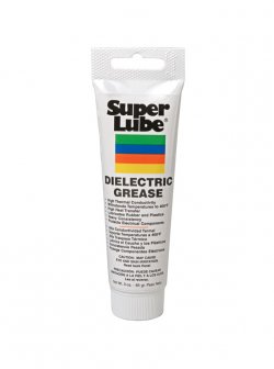

Someone might want to try dielectric grease; it claims high thermal conductivity (this I don't believe) but it is good to 400°F
Technical_Data_Sheet_Silicone_Dielectric_Vacuum_Grease.pdf (super-lube.com)
0.16 W/K m
I already tried petroleum jelly and it wasn't that great even if it beat SuperLube thermal compound, and yes I understand why one might not want to risk trying this.
