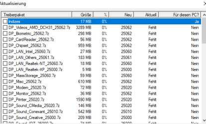

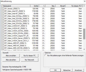

This is what the app is showing me
Click on "Indexes" to download, the first in the list and post a screenshot of the main program window, which should look like this
im kinda blind i think, what do i have to press here to get the list that you are getting
