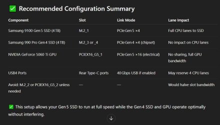

When it comes to "future proofing" and AM5 I have a love/hate relationship that mostly gravitates around expansion slot configuration and DDR5 memory support with 4 slots. If expansion slots are important to you for "future proofing" keep in mind ProArt X870E-CREATOR WIFI has some trade offs despite being a top tier motherboard that my limit you in what expansion cards you might want to put into your system.
** When you use both PCIEX16(G5)_1 and PCIEX16(G5)_2, they will run at x8 each.
*** PCIEX16(G5)_2 shares bandwidth with M.2_2 slot. When M.2_2 is enabled, PCIEX16(G5)_1 will run x8, and PCIEX16(G5)_2 will run at x4.
So worst in the worst case with fully loaded NVMe you have x8, x4, x4 slot configuration. In contrast with my B650, if I don't use my 3rd M.2 I can support x16, x4, x4 (at 1/4 of the price I paid then compared to the ProArt X870E pricing now) so you can see why I'm a bit miffed at AM5 offerings in that regard. In ProArt's defense it supports PCIe 5.0.
Thanks Computer Guy - this is the first build I'm doing fully myself, so learning all about lane sharing and such.
Chatgpt has been helping me... I hope it's not hallucinating and giving me bad advice. I have to double check with the ProArt manual but here's what it recommended to me, when I told it my setup (picture attached).
It also summarized the following:
Your Gen 5 SSD (Samsung 9100) in M.2_1 uses CPU‑lanes exclusively—no conflict with GPU in PCIEX16_G5_1.
Your Gen 4 SSD (Samsung 990 Pro) should go into M.2_3 or M.2_4, so it doesn't tap any CPU Gen 5 lanes.
Final tip: Avoid using M.2_2 or PCIEX16_G5_2, and keep USB4 disabled if infrastructure doesn’t need it, to maintain full Gen 5 bandwidth for your GPU/SSD.
So:
Samsung 9100 (Gen 5) --> M.2_1
Samsung 990 Pro (Gen 4) --> M.2_3
NVIDIA GeForce 5060 Ti GPU --> PCIEX16_G5_1
USB 4 Ports --> Avoid using M.2_2 to prevent lane sharing / reducing headroom (if utilizing high speed devices via USB 4 ports)
PCIEX16_G5_2 --> Avoid using as (PCIEX16_G5_1 and _2) are configurable as x16 when alone or x8/x8 when both used. (So bandwidth from 5060 Ti GPU would be reduced)
Would that be the proper configuration for my SSD's and GPU?

5060 Ti is a PCI-Express 5.0 x8 interface anyway so lane sharing isn't as much of an issue in your case with the primary PCIe slot - if that is the GPU your going with.
