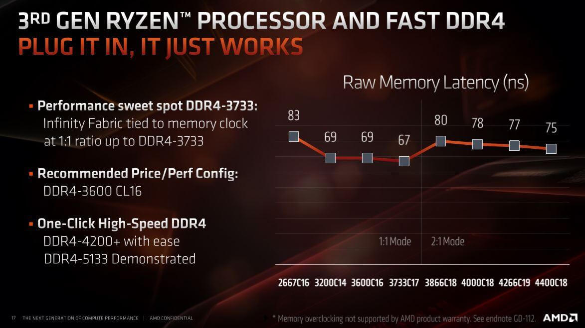

I thought the 1:1 ratio was only preseved until 3600?
Hmm, I read from AMD that it was 3733 that was the maximum 1:1 that infinity fabric could handle, and that AMD was just recommending 3600 out of caution. Anything above 3733 was stated to be a ratio. I'm just as surprised to see this 3800 1:1 claim, although the difference in benches or real world tests would be negligible.
That is correct from what I have read aswell! To be honest I think it has to do with RAM availability and the companies accepting that 3600 mhz is a more normal factoryOC-frequency. having to force alot of people into a 133mhz overclock might reflect badly upon their mobo's so they locked in at a safe 3600mhz. The practical gain from 3600mhz CL16 to 3733mhz CL16 is miniscule.

AMD claimed 1:1 ratio up to 3733Mhz
yet we can see 1900mhz fclock on 3700X in Bearded Hardwares last OC stream

Difference between 3600, 3733 and 3800 would be negligible indeed. 2:1 however, not so much.
Odd, maybe W1zz can drop AMD a few lines for a clarification?
That is their spec... what the AIBs do in their BIOS is a different story.
I've heard some go lower to make sure more memory kits can be approved/QVL as they were having some stability issues at 3733 1:1.
Joe has an exceptional chip. This isn’t the norm, I don’t think. Mine can’t go above 3733 without crapping out to 1:2 or failing to POST. I will also put that down to the board I’m on, and wait for a BIOS update to see if it gets better.
I think its because 3733 is a guaranteed and past that its silicon lottery to get 1900 fclk and uclk t9 run stable
Past 3733 its silicon lottery. Some chips may not be stable at 1900
