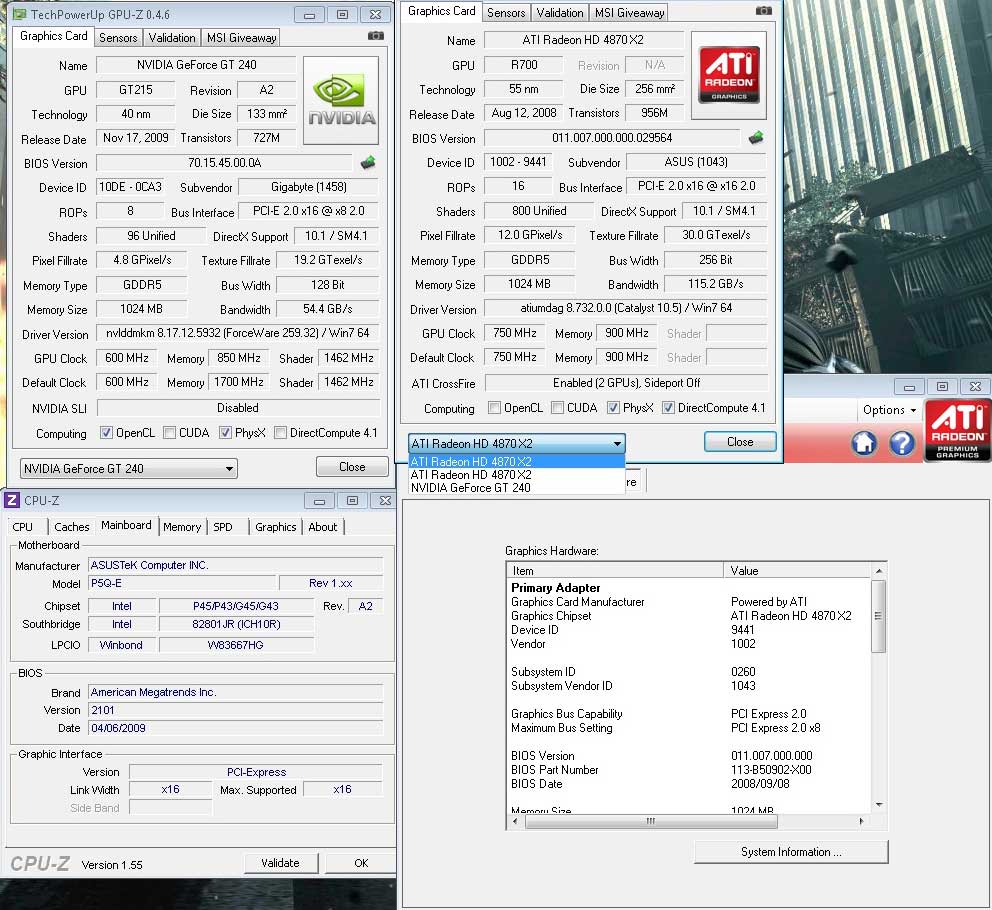

Dear W1zzard !
My Mainboard is P5Q-E chipset P45. I have 2 VGA : HD4870X2 and PhysX GT240.
When using two VGA, PCIe slot bandwidth of HD4870X2 is x8 2.0, but GPU-Z 0.4.6 and all version GPU-Z reported x16 2.0
attachment.php
This is also the problem of GPU-Z for HD5970.
Could you fix this problem ?
Thanks
