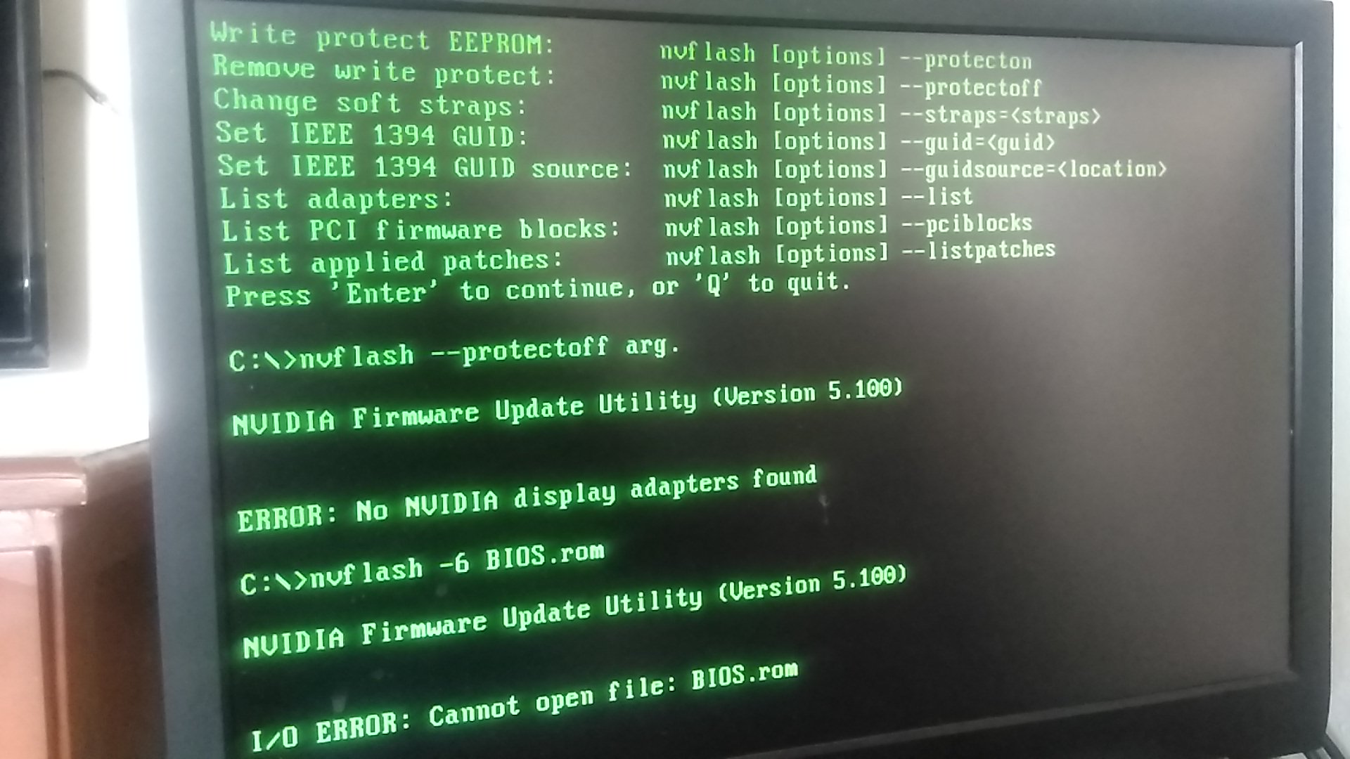

From hiren boot cd and I have this error
I'm conected from the GTX 670 vía VGA
Can I do now?
Thanks in Advanced

In Hiren's CD you should start "miniXP" and out of them you can access your disk via windows explorer and run nvflash using command prompt. Nvflash and BIOS have to be in the same directory/folder.
