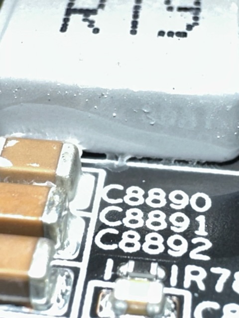

You used the very low water like viscosity STARBOND EM-02 Super Glue? How long did you let it dry before putting it back together. I am going to let mine dry 72 hours which means Sunday night and the stuff I used I do not think is as low viscosity as that. i just want to play it safe and make sure it works right.

Think I may see an issue. Maybe it was so thin it flattened/spread out and didn’t make enough contact with the board and choke? Maybe I have to build it up with another application?
I don’t know. Some look like good contact though…
qfg77 used this super glue: https://www.amazon.com/gp/product/B...search_asin_title?ie=UTF8&psc=1&tag=tec06d-20 on a Gigabyte Gaming OC RTX 4090
While not the same exact kind, it also has super low viscosity like water of 2 to 5 cps.
They told me it took 2 days for the noise to go away as the glue takes that long to fully harden even though it stops running after a few minutes and can be used after an hour or so.
Not sure if the glue you used is the same, but it has same ultra low CPS, so maybe.

I can give it more time. Ill check a few and make sure they have full contact and reapply if not. Ill check back in Sunday. Thanks for the help

Thanks for your advice to. I still have not gotten it to work yet and am on my 2nd try with 2nd 4090 after selling the other one. The other one I used Loctite Liquid Professional glue then immediately found out Loctite is not recommended. So it did not work after trying it after like 35 hours.
I not got the HFT super glue form Harbor Freight that Lex recommended and also made sure to apply it hard, though maybe over did it as there were so many gaps where nozzle would not fit so put more on to ensure it wicked through gaps. Not sure how long that needs to dry to be successful?
And thank qfq77. He gave me some advice on how they did the Gaming OC
If this does not work on the PNY I did, I am going to sell it and give the Gaming OC a try using qfg77 method, though no waterblock and just stock cooler with custom MSI Afterburner Fan curve as fans are ok but the default fan BIOS in Gaming OC makes fans loud unnecessarily. I will just have to somehow figure out how to pry off the PCB as I hear it is on there pretty good per Steve Walton at Hardware Unboxed. Even the PNY was on there tight enough that I had to fiddle with it. Are they all like that. Plus I went with PNY again as Lex had success silencing one and it has better fans out of the box so hoping my application worked once I let it finish drying.
Those look like polymer capacitors. No, don't apply glue on them, they can't whine.
MLCC (the much prized caps on Asus boards) are ceramic capacitors that can whine/rattle however, due to the piezoelectric effect. But even in their case, you don't apply glue on them as you can't prevent then from vibrating this way (or in any other mechanical way, in fact): Reducing MLCCs’ piezoelectric effects and audible noise.
People, please go easy on the glue on other components, you're hindering their ability to be cooled. Depending on how reactive the glue is, it can even melt the components protective case too.

In speaking of SuperGlue and how lexluthermiester stated I applied a bit much, do you know if that has any negative affect of the proper wicking needed to block coil whine on the chokes?
Or is it that too much glue risks other component damage like what you stated melting other components on PCB or blocking a conductive path that could make card not boot like qfq77 had with PCI-E lane on Gaming OC 4090?
Or both.
Part of the reason I applied a bit much was because of the parts where the tip does not fit in and lexluthermiester mentioned how you need to do that to get it to spread and wick. Just hard to do it excatly and sometimes it looked like glue touched a capacitor or part of bottom PCB but could not tell for sure in some cases as it bubbled up so wanted to ensure I got all choke sides wicked at PCB interconnect which is the bottom.
In terms of the 2 LR22 connectors, I had applied it to gap and tried to get it to come through though never saw a leak out on the floor, though a capacitor was so close by and maybe it was so light and hard to tell. Though at top I did see a thing bubble like moving at top even though I never applied any on gap at top of LR22 inductors indicating some form of liquid was moving on PCB floor between inductors. Perhaps the bubble affect as space was so tight it created a thing showing at the top thin gap? So just left it alone after that part and a few more squeezes to ensure it got all the way through as best as I could. Same with many other areas unless I directly saw the wet spot get on edge of PCB and choke.
Too much glue is not going to have any negative effect on the coils, on the contrary. The concern is about damage to other components, indeed. This kind of glue does its "work" by dissolving a bit of the surfaces it enters in contact with.

How does too much super glue damage components if it is non conductive? Is it just like non conductive thermal paste in that too much can still damage components if spilled, it is just pr0obably not, but still a risk? Where as conductive thermal paste if even one iota spills, say goodbye to a PCB? Also the risk of potentially covering something that could overheat unlike a non conductive thermal paste spill on a PCB motherboard or video card?

Basically, apply the glue to part of chokes that contact PCB. The bottom edges of them. All sides.
For parts where tip will not fit, try and put enough on PCB by part near Crack so you can see a puddle get to that edge. It's tricky to do. May gave to overdo it to ensure it gets to those spots.
