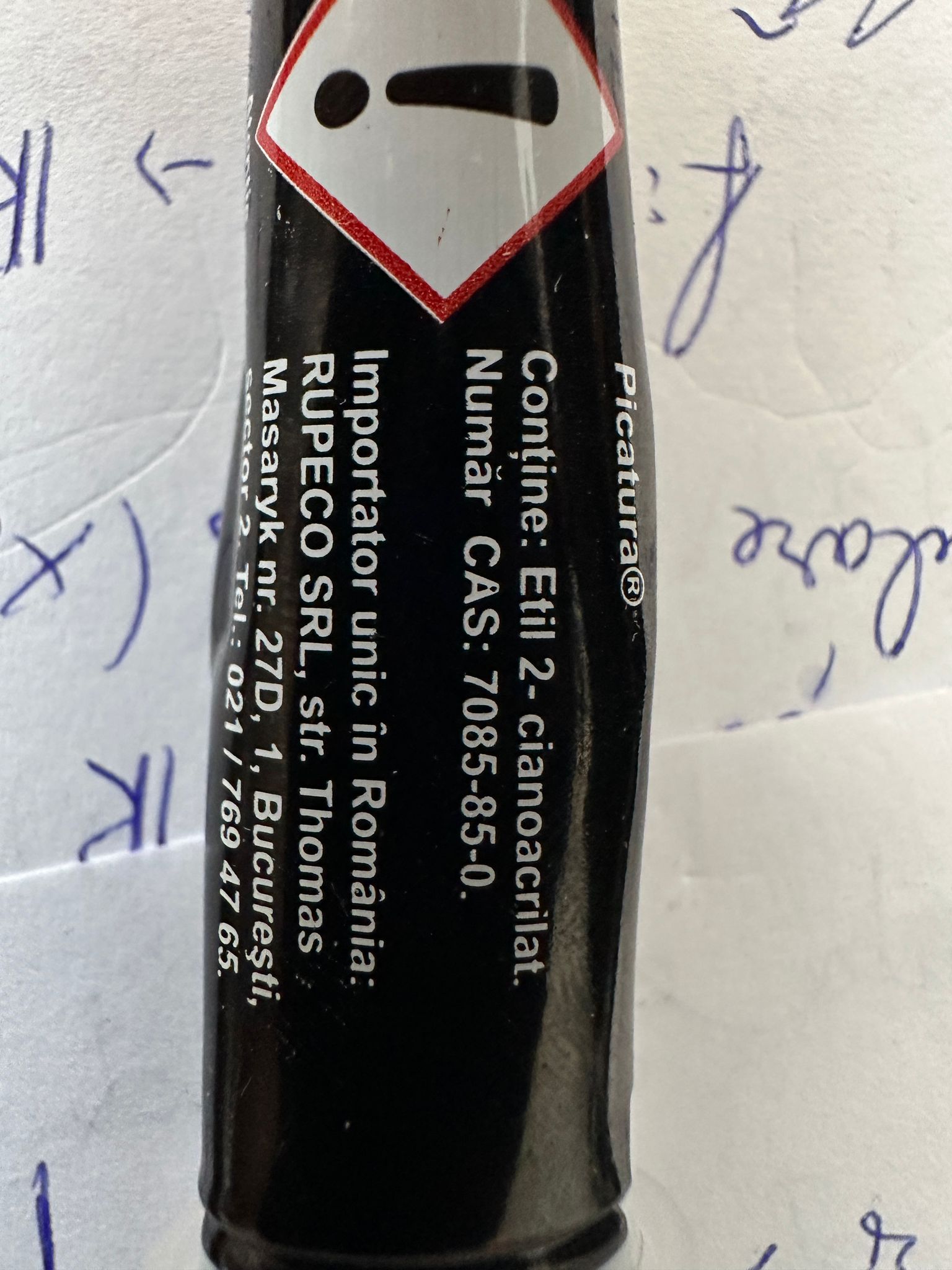

Hello guys, I tried the glue method(used a ethyl 2-CA glue, ethyl is not that strong of a solvent so it does not affect the PCB) and had no improvement. I left the glue to cure overnight (about 12-14h) and this morning I added a bit more glue, fired up RDR2 to test it and the whining still persists.

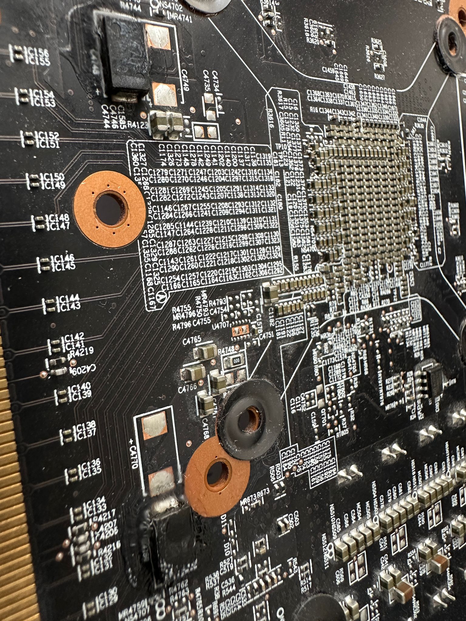

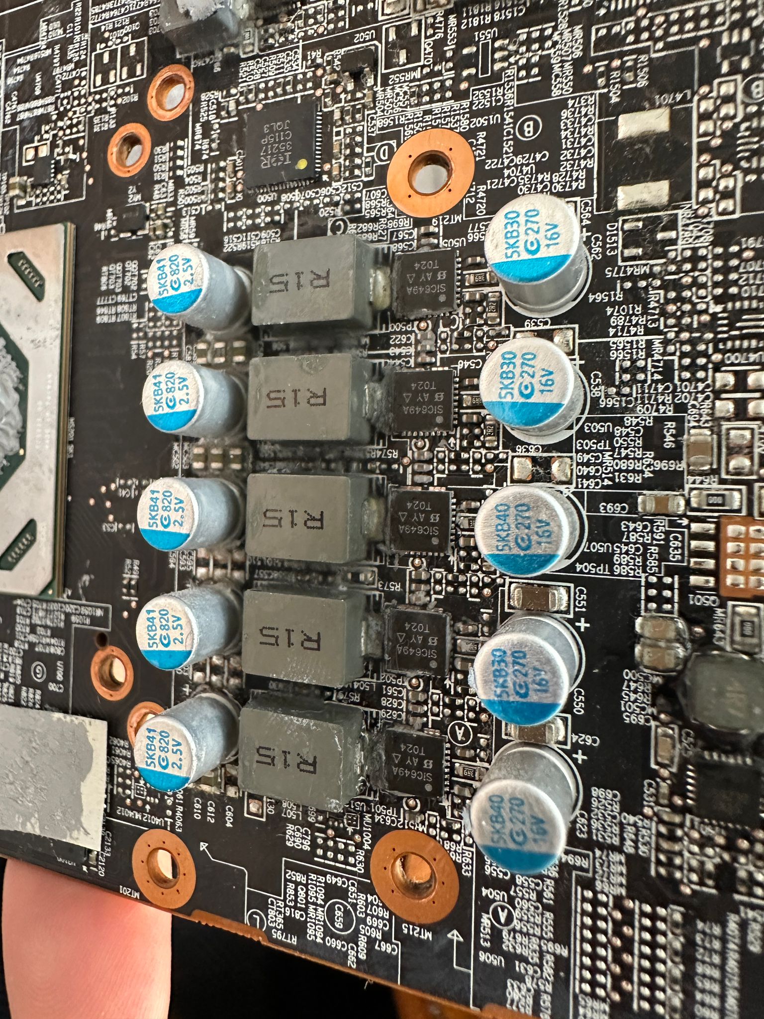

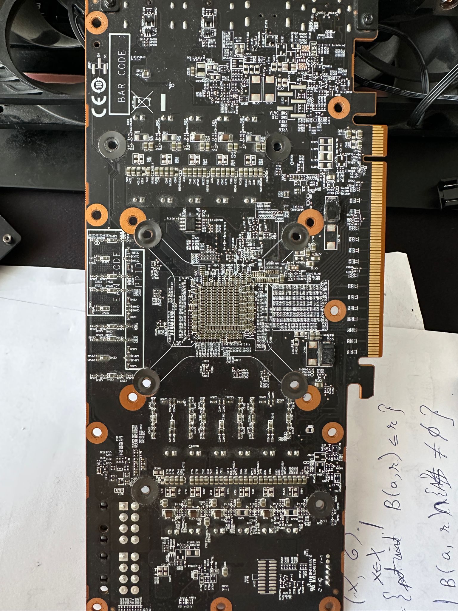

Thank you for your answer, I will comeback tommorow with lots of pictures. I found out after I made that post that I have 2 more inductors under the backplate, also glued them and now I am waiting for it to cure.
Here they are. I tried using a toothpick( tho my glued had a really small nozzle) and some inductors are still not completely surrounded with glue, they still suck the glue inside. I don't know what to do anymore, I have this gpu since July 2022 and I tried multiple things and this method is the closest I could get to fix the whine, I tested in multiple instances like letting it idle for a while while recording(for comparison, and it seems the idle whine is almost gone) and in demanding games like RDR2, instance when the whine is still there.

You might have used a bit much, but I can't find anything you missed. You did a decent enough job of it that if the problem was the chokes on the card there should have been some level of result. Maybe mobo or PSU? Or you might just have a card that is noisy beyond what can be suppressed. Sadly, it goes that way sometimes.
It is possible the vibration causing the whining is happening inside the "can" of the offending component and I don't know of anyway to fix that other than to replace that component.
I am not sure what I am looking at when I look at your images. What I do see appears to be a lot of dust. :( Look at all the dust on the finger contacts on the right side of the 2nd image from the bottom. The first 4 images look pretty clean. The rest do not - at least from here. If me, I would have made sure those boards were sparkling clean before applying any sort of glue or TIM or anything else.
