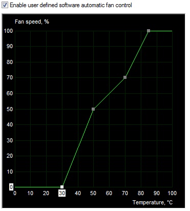

Why not just use MSI afterburner and set your own manual fan curve. Is a lot safer and less likely to cause an issue.
yourig
Mar 15, 2020
7 (0.00/day)
I've tried, but it won't go below 41% fan speed. For some reason it's locked.

If your fans are noisy at idle, you don't have to cross-flash, just download MSI Afterburner and setup a custom fan curve like this:

The fans won't go under 21% event when i make a custom fan curve. I also did a accelero extreme swap and thought i can go with these under 21% .. but the bios is preventing it.
And because of the Accelero Xtreme Swap i want a bios with zero fan mode and with slight higher TDP
