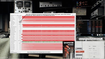

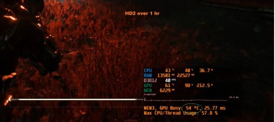

My GDDR5X hottest VRAM sits at 56 C when GPU is 60 C and H Spot is 74 C. 3x 92mm @1400 +1 x92mm @ aprox 800-1000 Rpm.
See for yourself pwr draw 316 W max avg 256W
Not sure I've seen my VRAM going to 65 C yet.
How can I without AC and an air cooled card in a shitty modified Lian Li able to achieve that and AIB can't??
Show me a stock air cooled 1080 Ti running that VRAM temps out of the box. I personally don't know but, if you found one I'll be very interested in that particular AIB.

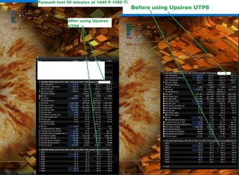

This is an EVGA 1080Ti ICX?
Yes FTW 3, 3 sensors on each memory group.
I bought it second hand and in just 5 min FurM test one group Mem3 went to 71C and some power to 76C.
Superposition uses way more VRAM than FurM, yet my MEM3 doesn't go not even on 60 C, same mem group that went 71 C with old leaky pads in Furmark 5 min test
Thermal putty + fan on the back + removed grill for rear case fan etc all done by me, not Lian Li or EVGA.
Still have one issue to resolve card sits 3cm away from glass side panel, thanks to Lian Li design for XL cases, recirculating hot air:shadedshu:. 18CM width on main case chamber is just a SAD joke, is like a prebuilt cheap case:banghead:

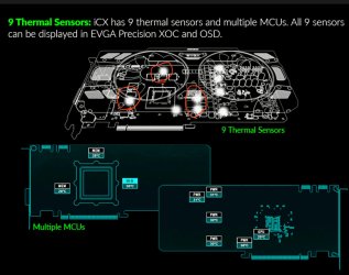

The profound difference between EVGA iCX cards and RDNA3/4 cards is that EVGA reports PCB temperatures near(on the side of) some VRAM modules while RDNA3/4 cards report hotspot of junction temperature and those sensors are located exactly underneath the VRAM modules, which is the closest point to the VRAM silicon that gets hot. Any closer than this you are inside the chip.
It’s apples and oranges that are not debatable for comparison.
The real difference between those 2 cases can be more than 20 degrees C.
I don't know about "oranges" much yet, I don't have it and if the sensors are under VRAM, I'm happy because are more accurate, however I'm confident AIB cut more corners compared to the past when comes to cooling.
But back to the "apples" 1080 Ti
How come a difference of less 10 C to GPU 8C to Mem3, 6c to Mem2 and 8C to PWR4 sensors?
If AIB does closest to perfection cooling solutions, how come with just different TIC and a silly fan on the back you can improve that much the temps. Still don't think the gap is to wide?
Another remark, if 9000 series has sensors under VRAM than the heat traversing PCB, cooled from the other side of the GPU might have a greater impact to sensors AVG temps IMO. But will see.
Initial test bellow 5 min Furmark , and I will make another test in about 1 week with same length.
