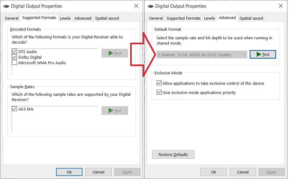

Thank you for you help buddy. I did only the digital endpoint & it showed up in both.
It's not working on the Cmedia CM6206-LX USB.

Dolby Digital test sound does come out on supported formats tab?
Yes, that's correct. Still getting pcm 2 channel stereo from my lg bh6720s.
OK, that appears something beyond the USB device is wrong. This supported formats page test button does a bitstreaming of a preencoded Dolby Digital signal; something is decoding the signal to PCM beyond the USB device, or something might be misconfigured on the receiver.
And to connect, is it a direct connection from the usb device optical out to the htib receiver optical in?
Do recheck the speaker setup settings, if it is properly 5.1.
Yes, it's all setup correctly. If I watch a Dolby Digital 5.1 or DTS 5.1, the bitstream is activated. However the Dolby Digital Plus is not activating the DD3/2.1 symbol on my receiver.

@CityCultivator Only stereo though, Left Channel & Right Channel on the test.
@CityCultivator When I do a Test I get a pop & then only the left & right channel chime from the test.
On that page you were supposed to get the Dolby Digital in the advanced tab; I don't see it.
Also There is usually a Dolby tab present.
See as you did on your speaker endpoint.
FX Configurator has applied on the wrong endpoint. Guess it is a bug in FX Configurator.
Can you provide a list of all endpoints you can see?
Not all drivers allow multichannel out from SPDIF. If the device has restricted input (2 channels), even with an encoder, you still get 2 channels.
I tried to write a driver for USB, and I found that its OEM locked to 2 channels, and its not easy- not possible to work around it.
You will probably need to modify the driver to allow 6 pcm channels in, to be processed by Dolby.

So you are receiving 5.1 (DTS and Dolby is coming in as 6 channels, but only 2 have audio). I just tried VAC and it does output 6 channels to my SPDIF, however it already accepts 6 channels of PCM.
I was intending to modify it to add the encoder to it, and then send that stream to SPDIF already encoded, but it will require me to rewrite the app :(
You have (probably): 6 Channel PCM > SPDIF, restricted to 2 channels > Encoder (only 2 channels) > 6 channels out, only 2 populated.
What you want: 6 Channel PCM > SPDIF, no restrictions > Encoder > 6 channels out.
Alternative: 6 Channel PCM > Virtual device > Encoder > Passthrough to SPDIF. < Clever and some money to made there (app).

When I watch Dolby Digital 5.1 & DTS 5.1 movies, I get true surround sound out of all 5.1 channels.
When I activate Dolby Digital in the Advanced Digital Output properties, I get some scratching & popping & a chime from left channel & right channel. So only Stereo Dolby Digital (Live) from SPDIF.
If there is anything you can do, that would be awesome? Unless its unsupported in hardware?
"When I watch Dolby Digital 5.1 & DTS 5.1 movies, I get true surround sound out of all 5.1 channels." < Correct, its already encoded with all channels present.
Have you tried an upmixer? Try this app and guide, if you are getting noise on the extra channels that's interesting, still might not work.
The problem is the hardware SPDIF setup is restricting the input for the encoder to 2 channels.

@Ferather Thank you. So its a hardware limitation? Thats too bad. I don't really want to upmix, thats like virtual surround sound.
I know we've been over this already but I tested again the "test button" in Supported Formats tab & I hear everything out of all 5.1 channels on Dolby Digital & DTS. On the Advanced tab "Default Format" of Dolby Digital, I only get left channel right channel on the test. So I guess this is a hardware limitation?
When you tested on advanced tab,
  1. Were you able to select Dolby Digital?
  2. If yes, were you able to hear anything (in front left, front right)?
He only gets stereo, left right with it selected, the driver or hardware is either downmixing multichannel to stereo, or dropping the other channels, pre-encoder, the encoder only receives 2 channels.
