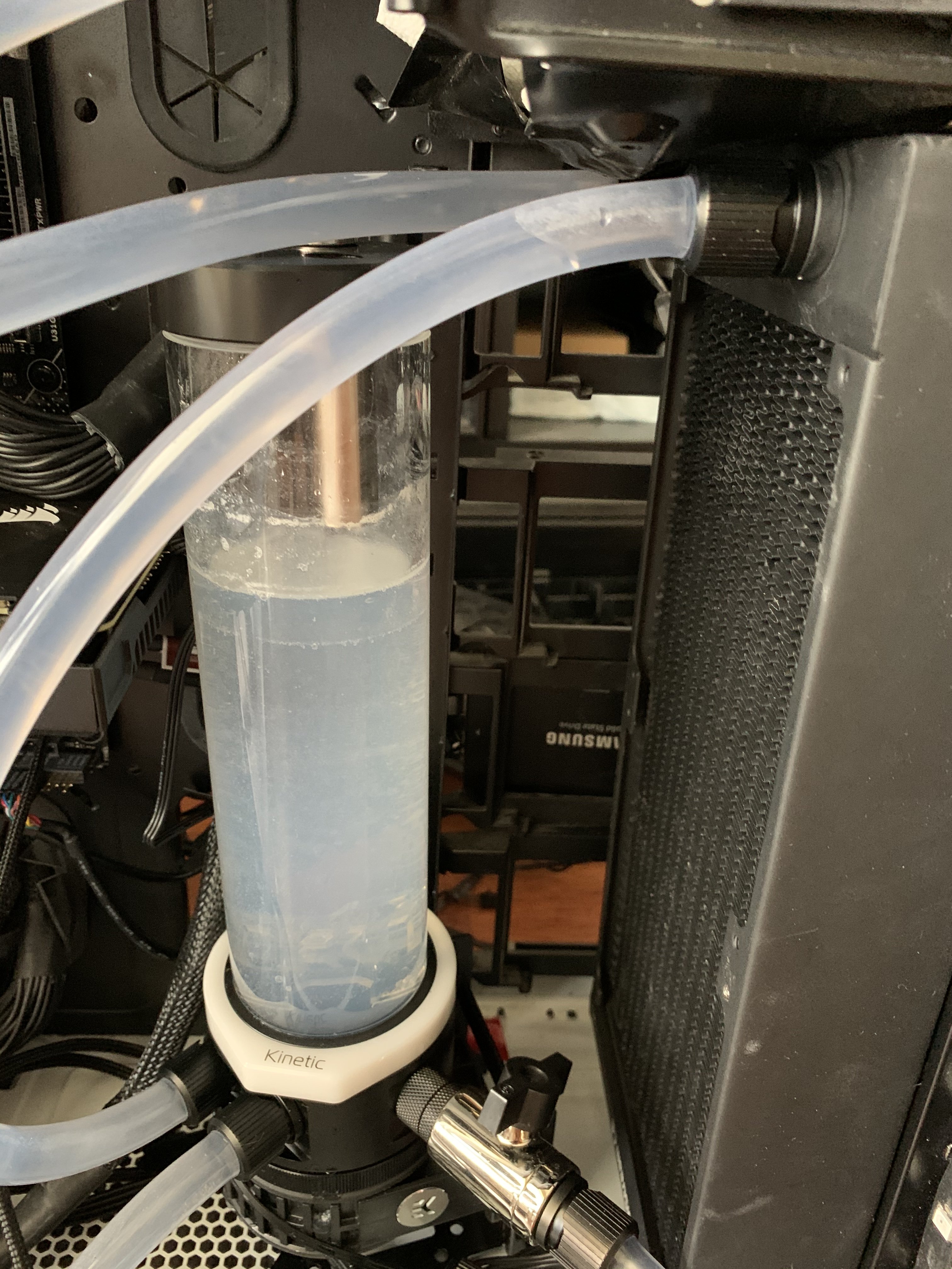

What is going on guys? I flushed with distilled water and nothing happen but when I put the EK premix coolant and so many bubbles and crap stuff. Is it normal and will go away with time?
Just flushed out again and added more new coolant and its clear now. But why when I turn off the power, the water coming to the rad just stop. Does it mean the whole loop not full?

air trapped in the loop, that is normal it will go away soon. Try to tilt the case back and forth until the air back to the resERVOIR.
I use EK Premix also, like HUSKIE said, that's normal. Let the pump run for a while and the bubbles go away.
Do we need to fill the reservoir full or just as it is now?
Eek, what's that gunk or residue? Or is that part of the premix?
I generally fill it and the trapped air will eventually make its way to the res over time giving you an air gap. If you don't fill, just monitor the water line and if it gets low top it off.
I have it 1-2cm higher than you have, but not more. Leave the reservoir open till all air is out, so 1 week should be enough, then close it.
You don't have to leave it open and leaving it like so for a week is crazy. As I wrote above, trapped air will make it to the res. NO NEED to leave loop open.
Ok, I did it to make sure to release pressure, then I closed it.
Don't bother about the air trapped, as I said it will go away soon, don't fill the Res all the way just leave some gap, don't open the cover just leave it close. It will take sometime, 1 week is too much. Based on my experience it will take 2-3days, it depends how long you using the pc.
