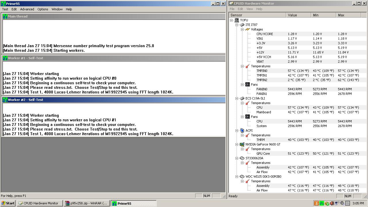

now its running, all you need to do is take a screenshot like you did before with CPUID HW monitor running as well that will tell us the max temps your cpu is hitting

Well, I have a SS of CPUHW after 5 minutes or so of being on. So far its lookin like overheat could be it. 10 degrees F in 5 minutes or so... :/
24 C to 38 C in bout 10 minutes

Here's one. I hope I did it right....sorry for double post. Figured Id put this new SS in a different post.
EDIT: This 2nd post is after bout 20 minutes or so of being on I think....
EDIT EDIT: Keep in mind, 2 people are up here and its 65 degrees in this room...

EDIT: Well, I think sensors might be screwy. It says it's at 70 C right now...I've NEVER seen it that high, and it's not howling. Nor is the case really hot to the touch. Its also still 'cold' in the room....And the 920, according to what was posted last page, is supposed to fry past 63 C....
EDIT EDIT: Yeah...it dropped back down to 65 in less then 5 minutes...I think the sensors are screwy....
Looks to me like 1 minute after starting that test you were at 54c...and your system is idles at 30c... whether that's the cause of the slow down or not It's still bad That's 9c away from Critical after 1 minute of testing.....Not good at all

EDIT:EDIT: My cpu goes from 21c-30c in less than 2 minutes and up to 40c within 5 minutes and back down to 36c after 7 minutes with Prime95 those readings may be correct
Here is a screen shot
Yeah it hovers round 58-59 C now.
