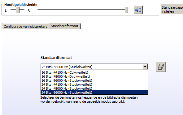

I've a problem with a HP Pro 6000
In the manual it says that the audio is sampling from 8 khz - 192 khz, but the maximal sample i get in Windows 7 with latest drivers it is 96Khz.
When i google on the ALC261, Realtek said it can handle 192khz, but i dont get the option in the Audio panel of Windows.
In the Realtek Config neither.
If it's technically posibble the Realtek software has the wrong max samplerate, how can i change the software or fooling the software?

Realtek forgot to add it to the ALC261 driver.
Yeah, but technically it's possible to get an 192Khz output and i want to know what i have to do.
You're right to want the PC to work to its rated spec, but I'm afraid you're out of luck on this one as its rated spec is only 96KHz.
Frantically Googling it, I can't find the audio specs on the HP website, nor for the ALC261 on the Realtek website (crap company pulling info). However, I've found the ALC261 spec on the third party website below and guess what? It only goes up to 96KHz, so this looks like a misprint in your manual. You'll just have to buy a separate sound card to get 192KHz.
The ALC262 on the Realtek website does 192KHz.
EDIT: here's the product page for a better HP PC, the 8100 and the spec there shows 96KHz too.

I did several tests using the Realtek HDA Driver Test Utility and unfortunately I was not successful in enabling the 192KHz format.
I also have a model identical to the one posted here.
You wont be able to bypass programmed chips, its likely the DAC's and-or digital converters are only supporting 96k, else 192k would be there by default.
Another way to put it, is in sample aggregates, for example 8 x192k = 1536 total aggregate samples, 8 x 96k = 768 total aggregate samples.
There will be essentially two reasons 192k will not show, the chips don't support them, not enough aggregates.

eidy, the sound chip just doesn't support 192KHz. Check out my reply in post 8. :)
well said
ALC261 is a "primitive" audio chipset along with ALC880 & ALC861 (right around the time when the HD audio standard first came out in 2004/2005)
forgot to mention last time, ALC261 and ALC861 support up to 96khz sample rate so it does NOT matter whether using modded or non-modded Realtek audio drivers - the 192khz option is never available for these "primitive" 1st gen realtek hda devices.
I know because I used to have an old Intel motherboard (I think it was a D101GGC model) which had an onboard Realtek ALC861 audio chip and installing any driver only provides up to 96Khz sample rate in the Default Format setting in the Realtek HD Audio manager app
those ALC261 and ALC861 chipsets are weak. on the other hand, maybe ALC880 might support 192khz as noted in this specs doc
