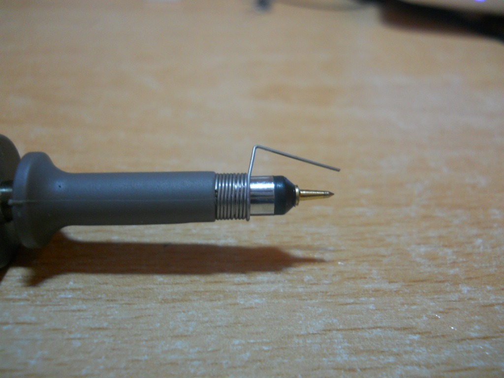

Late to the party, but I wanted to chime in. :D
So, I bought one of these out of morbid curiosity. I hooked it up to a Chroma 8000 to see how accurate it was. I have to admit, I was pretty amazed that this thing is pretty accurate for current and voltage measurement.
The only thing that isn't accurate.... at all.. is the ripple. My best guess is there's a good deal of noise being measured as well. But this is so easily bypassed. You can use a cheap scope as long as you can limit bandwidth to 20 MHz. Use a probe tip spring adapter (picture attached) and put it into the back of the + and - of the connector of whatever rail you're measuring and even without the differential caps. We have the differential caps built into our fixture board and when we compared the ripple through the fixture versus just using the probe tip spring adapter, we only saw an extra 3 to 5mV of noise, which was still WAY LOWER than what the Passmark tester was measuring.
So in a nutshell, I would say that if you wanted to review PSUs, you could easily use this device in conjunction with an actual oscilloscope and get some pretty good results.
We've been asked about the ripple measure a few times. As far as we known there is no standard way of measuring ripple for PSUs i.e. the standards are vague on the exact measurement method to be used.
Some of the points that aren't covered in the standard, and are left up to the technician to decide on are,

Our current method is as follows:
We sample the voltage on each rail at 10K samples / second. We then take 1 sec of data and search for the absolute min and max of each rail, every second. The min/max difference is reported as ripple. These 10K and 1sec values are somewhat arbitrary, as there is no spec. As far as I know most people either aren't reporting on what their test method is or don't know what what they are measuring. (JonnyGURU being an exception here, as I am pretty sure he knows what he is measuring).
Note that this is under firmware control. So if some standards body did publish a spec on the measurement procedure, we can update the ripple computation in firmware to match the spec.
The voltage measurement precision in our tester is +-4 mV in the A/DC. If you suspect numbers are off more than this, then there is a calibration process that can be followed (if you have the high end gear to compare to). Page 20 of User's Guide
Like I said, you would normally limit your bandwidth to 20MHz to eliminate high frequency noise. My guess that's where the tester's high test results come from. Bandwidth may not be limited by youtr device and you're reporting some high frequency noise as ripple. Obviously, labs using ATE's have direct BNC connections from the ATE to the scope so you don't have to take this into consideration. But as we used a probe tip spring to confirm the discrepancy between the BNC on the load fixture and what we were seeing with the Passmark tester. Probing the connector through the back of the connectors showed us that we could still reliably measure ripple using a run of the mill oscilloscope. Like I said, we only saw about 3mV of additional ripple due to the lack of the 0.1uF and 10uF caps that Intel suggests using, which is built into the ATE.
Maybe a next generation version can provide test probe ports so it's easier for someone to use their own oscilloscope, or better yet.. a BNC connector that they can attach directly to their scope.

...you would normally limit your bandwidth to 20MHz to eliminate high frequency noise
This is done in the device with a RC filter on each rail. So this isn't the cause.
Yes, we agree this might part of the cause for the ripple measurement difference. BNC connectors with coax cable would be a lot more immune to external EMI than the typical PSU cables used in a PC.
Using a probe with a spring tip that minimises the loop distance would also help. What I have done in our device is that the signal travels to micro controller via one of the internal layers which is between two ground planes to minimise interference from other signals and environment but there is still a large loop (about half the size of the tester's PCB) that can not be eliminated easily in this type of device. EMI inside the case of a PC, right next to a PSU with inductors is always going to be worse than a lab environment.
It is also a cost benefit trade off as well. We could design a unit that measures ripple more accurately, but not at this price point.
I'd still be much happier if there was a clear specification for ripple measurement. Will never be consistent results otherwise.
...additional ripple due to the lack of the 0.1uF and 10uF caps that Intel suggests using
These two caps are in the device. Photo attached.
