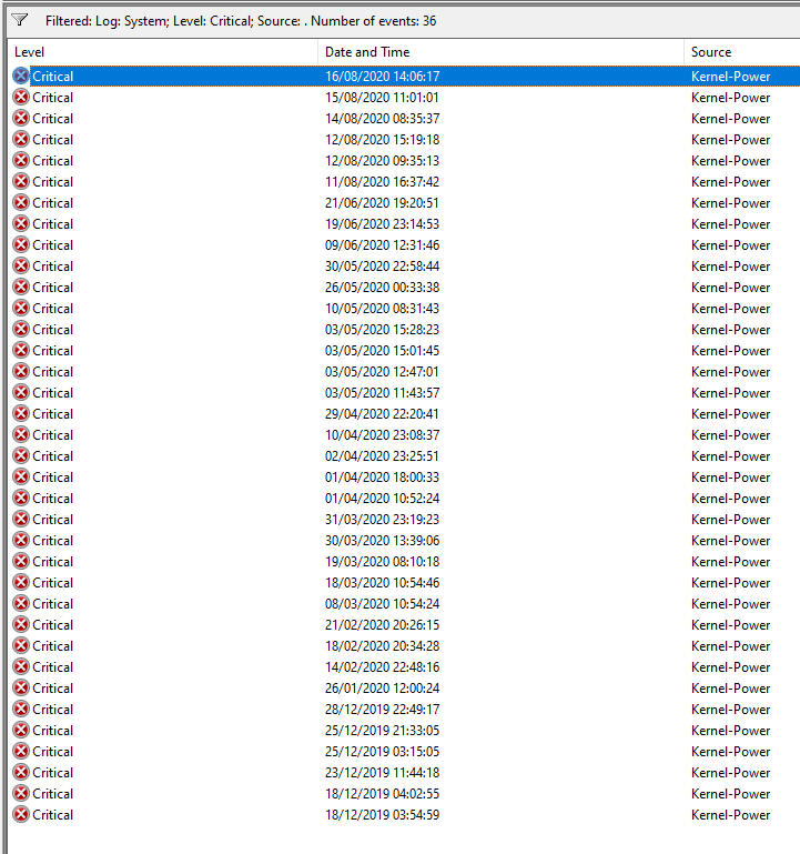

Hey guys, I could use a little bit of help here.
Ever since I swapped my MSI B450 Carbon Pro for a Gigabyte X570 Aorus Ultra that my system randomly reboots. There's no BSOD (and yes, I have the option to automatically restart on system failure unchecked), it just freezes for half a second and reboots. I haven't been able to pinpoint a cause for this, as far as I can tell it's completely random. Most of the times it happens when I'm not even using the computer, sometimes when I'm browsing or doing light tasks, a few during gaming. There have been 36 restarts since mid December 2019 as the event viewer logs show. There's also nothing that indicates causes. Screenshots of the list of errors and logs of the last time it happened.
This is a really pain in the ass to test because sometimes there's a really long period of time between restarts, as it shows on the log, I had no issues whatsoever in July despite longer usage than normal.
I have a few suspects but I'm not even sure if some of them would cause power loses/restarts. So I want to read some opinions before I start replacing or RMA-ing stuff.
1. RAM
I could never get this kit to work at rated speeds without loading the XMP profile on either board. On the MSI I could get it to work using slightly worse timings, on the Gigabyte it's even worse. I've read somewhere XMP profiles can cause some instability on AMD systems but I'm not sure they could cause these types of issues. Isn't it typically a BSOD?
Also, I ran a memtest for 8 or so hours one day to see it there were any problems, but it didn't catch anything.
2. 8-pin connector
When I replaced the board this bad boy was a real struggle to connect. My PSU has in-cable capacitors and the fit was tight, must have taken me a few minutes to get it on and I guess I could've damaged in the process? Again, I'm not sure if a bad 8-pin would cause random reboots (wouldn't they be more likely at CPU load, if anything?) but hey, it's power related. I could also use some input on this. I took a picture of the said cable and it's awkward angle.
3. Faulty board
If all else fails it could just be a faulty board, I guess.
So, if anyone has any ideas what the culprit could be I'd really appreciate the help.
Thanks!
EDIT: Mistakenly called my board Aorus Pro rather than Ultra.

I would start by swapping in a known good PSU - not because you had problems installing this one but simply because you need to verify your system is getting good, clean and stable power.

sounds like PSU issue

You guys think it could be the 8pin cable causing it or the whole unit? It's still fairly new, it'll be 3 years old in November.
I still have my old Corsair from the previous build in storage, I'll try to replace it today and test drive for a month to see it fixes it.

Finished swaping the PSU. I'll monitor the situation, but I've gone a month a half without a reboot before so it'll take a while before I can say for certain if this was the issue.
It's going to be torture though. My old PSU might as well have been a fanless model, I don't think the fan ever spun. This one is so loud. By far the loudest thing on the PC right now. :cry:

Read through the following thread to see you aren't the only one with issues with a Gigabyte X570.

Gb has issues with their boards since they introduced dual bios, so its affecting intel and amd, but still wont acknowledge that they have an issue in their forums.
if it happens again, try the F20 bios (only one i got to work without issues), but make sure to use efiflash to update, incl clearing DMI and updating backup bios,
reboot and qflash (incl backup bios) to remove any leftover data from previous bios (they seem to not clear any existing data in qflash/flashback mode corrupting settings).

Try the PSU. had this issue a while back and swapping out the PSU fixed it for me

have you checked your heatsink, could be from PSU or VRM but since you have changed the board we can assume it's not from the board
btw what peripherals that you connect to mainboard, vga card, soundcard or something

@micropage7
(lol, assumptions are really helpful for troubleshooting)
might wanna start reading all answers posted, as you clearly missed caring1/mine.
this CAN (and unless defective psu, most likely is) be coming from the board,
as there are lots of ppl having trouble with Gb boards (that use dual bios), including myself.
when i swapped the board the problems (cold boot/sudden reboots) went away, even when using the same psu/cpu/gpu/drives/cooling,
and only (dos) flashing both bios chips fixed those issues, so i know the board is not broken (hw).

@altcapwn There's no relevant information on the KernelPower entries, but here's a screen.
