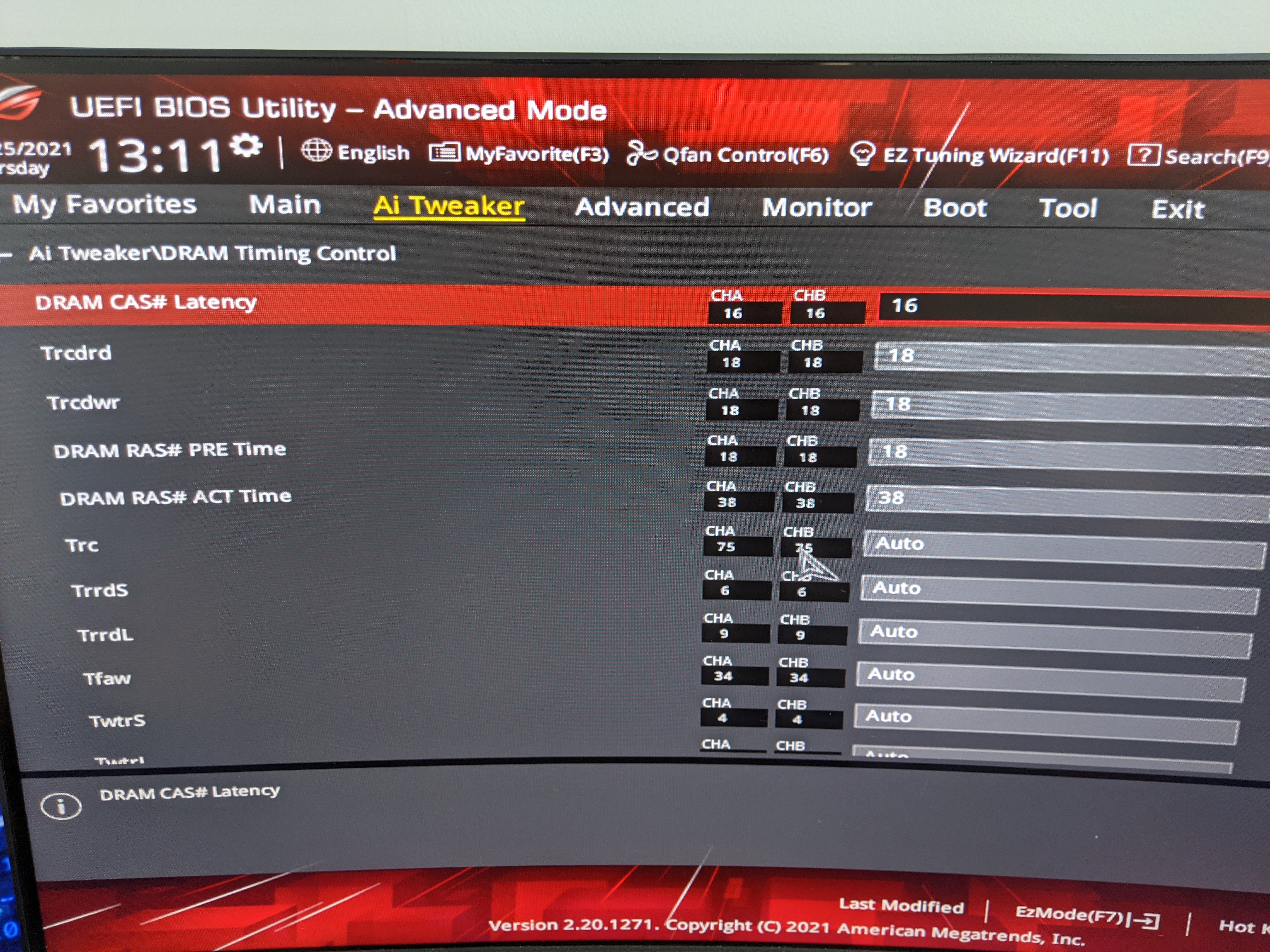

I'll look at my settings right now, and post it. it was very stable with my 3700x (for memory)
"very stable" based on what? Lack of prior crashes? From what I understand, AMD is still ironing out the kinks with the AGESA for the 5000 series CPUs so it's possible what was "stable" before with your 3700X is not with your 5800X
The system is obviously NOT STABLE.

Oh yea his settings contradict each other, oc control set to auto, yet uses asus level 3 oc enhancement which is an extreme level, then slaps on a negative voltage offset on top of that, and I wouldn't be surprised if a lil curve enhancement isn't used.

lol, you're using level 3 oc! And you're using a negative offset, why???
The system is obviously NOT STABLE because you're overclock is not stable.

You should never carry your settings over to a CPU of an entirely different family......start over from a CMOS reset. Leave the auto OC features alone, just set DOCP. At this point I highly doubt its a memory issue but you can easily test that later with HCI or TM5.
Frankly I don't even recall Level 3 to be an option on 500-series boards. Is that a holdover from the 400-series UEFI, that they've tacked on 5000 support to?
If you want to undervolt Ryzen 5000, the curve optimizer is the way to go. Lots of good info here, whether u just want to undervolt or want to undervolt+OC at the same time
Negative offset, because the voltage is way too high on stock, issue seen on alot alot of board But hey, thanks for pointing that, the 3700x was using LVL 3, because on other level, the boost wasn't normal, so I thought I would leave this on LVL3, because that damn Asus board always been special, IMO. I've not doing advanced settings in computer for a while, so I can miss sometime.

No currently up to date board runs Ryzen 3000 at "high voltage" out of the box as is (default is PBO Auto = essentially disabled). If this is the 1.5V you're seeing at idle, there must be a billion threads by now out there explaining why this is been normal behaviour since Ryzen 3000. I'm not going to waste time on this - just google "ryzen 1.5v idle".
As long as stock settings run an all-core benchmark at 1.35V or lower, it's not being overvolted.
All you're doing with a manual offset is killing your single-core boost performance, because PB2 is designed to leverage up to 1.45-1.5V in light boost to hit those sweet numbers. If your cooling isn't ITX-grade and necessarily extremely limited, lay off the "dumb" method of undervolting.

Just set back the performance enhancer to default (from a cmos reset), set D.O.C.P to my ram speed, just set yhe Fabric to 1600 to make sure it match .
