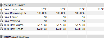

Tried my video folder from my intel 660 to my usb 3 2.5" harddrive (backup), it peaker just around 100 mbs, mabye an avarage of 85-90 mb/s it was never more than 41 c hot
what you tried would never heat it up as the external drive is bottlenecking the speed.

The samsung 970 evo 500gb i had a few month ago was sooooooo hot, close to 70c when i had it under my heatsink (no sticker removed), couldn't live with this kind of high temps close to my gpu.
I've got the same drive. Sure it gets toasty under load... mine will go as high as 75c with no heatsink. Briefly.
But it's not even a thing.... as soon as activity drops back down it's at 40c. Near instantly.
No gpu temp problems either. Haven't compared but I'm at 55-65 lately, depending on the title. Done so many builds with them adjacent to GPUs with no problems. I mean... when the GPU is working its hardest, ie gaming, the SSD isn't exactly getting nailed with massive r/w operations. Little dings here and there.
But even if they were both loaded down together it wouldn't matter much.
I mean... it's not just temp. It's mass too. How much heat capacity could a piece of silicon the size of a stick of gum possibly have? Point is... yes the temperature gets high. But that doesn't mean it's a lot of actual heat energy. Something so small can only gather so much... even though temp rises faster. And in reality, that happens simply because it is smaller... it doesn't take as much heat energy to raise the temperature of such a small object.
Which will do more damage? A penny heated to 200c? Or a 4' piece of rebar heated to 200c? Which carries more heat?
