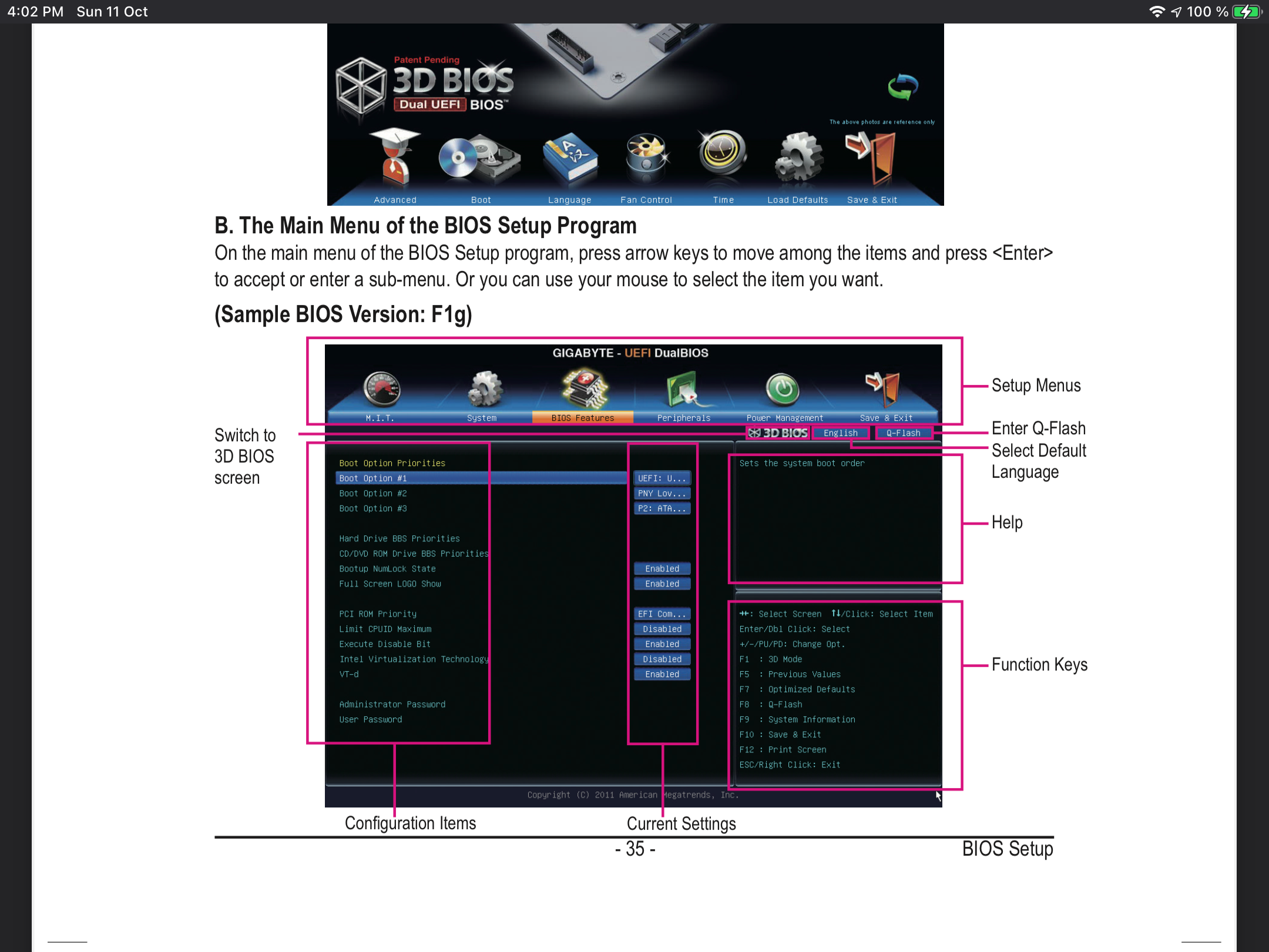

Well I has skimmed the manual and dual bios was mentioned and makes sense being the first UEFI attempt to have the AMFI bios as a fallback. I’ll poke through the manual again but I would think it would just be a different key press on Boot to go the “other one!
Well all I can find referencing any kind of Switch“ is this or also pressing F1 “Switch to 3D BIOS Screen“
Yeah that goes to a screen of an interactive picture of the motherboard, it contains the same options as far as I can tell. I will also investigate to see what I can find!
