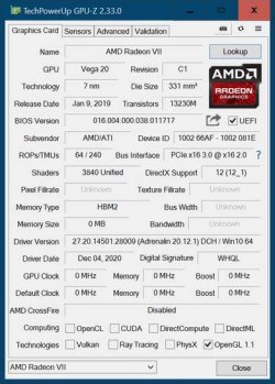

GPU Z and AIDA64 recognize the card, but the first displays some strange values (for example 0 Gb memory).

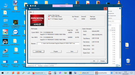

I have read that this error could be fixed by re-flashing of Vbios, so I decided to make a try. I used Atiflash program and Vbios from Techpowerup
it was exactly the same Vbios that GPU Z displays.

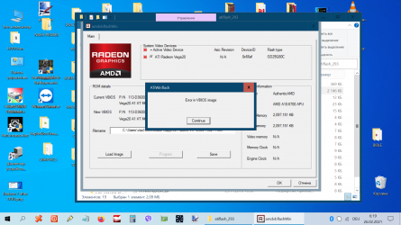

I followed all instructions, but when I click Program button, after 2 seconds comes the message "Error in VBIOS image".
I couldn't find anything about this error in the Internet, so I decided to ask here. I attach some screenshots to clarify details.

Welcome, a very odd issue, if you take a look at the link below, I have taken a look in our unverified Bioses and that comes up with 4 entries, the first on the list is the Bios you have attempted to flash, the 3 below are a different bios , might be worth a try flashing one of those.
VGA Bios Collection | TechPowerUp
Hallo, Tatty, thank you very much, 2 of Vbios worked by re-flashing (one as Uefi version), but... unfortunately the error code 43 remains in device manager.
