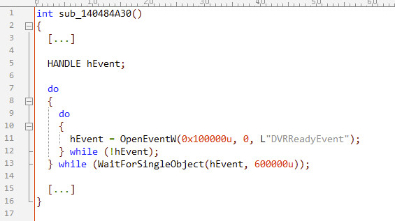

I attached my debugger, looked for the thread that's causing all the CPU load and found this:
Hard to read, translated it into C code it might make more sense:
If you're a programmer you'd have /facepalm'd by now, let me explain. In a multi-threaded program, Events are often used to synchronize concurrently running threads. Events are a core feature of the Windows operating system, once created, they can be set to "signaled", which will notify every other piece of code that is watching the status of this event—instantly and even across process boundaries. In this case the Radeon Settings program will wait for an event called "DVRReadyEvent" to get created, before it continues with initialization. This event gets created by a separate, independent, driver component, that's supposed to get loaded on startup, too, but apparently never does. The Task Scheduler entries in the screenshot above do show "StartDVR". The naming suggests it's related to the ReLive recording feature that lets you capture and stream gameplay. I guess that part of the driver does indeed check if Radeon hardware is present, and will not start otherwise. Since Windows has no WaitForEventToGetCreated() function, the usual approach is to try to open the event until it can be opened, at which point you know that it does exist.
You're probably asking now, "what if the event never gets created?" Exactly, your program will be hung, forever, caught in an infinite loop. The correct way to implement this code is to either set a time limit for how long the loop should run, or count the number of runs and give up after 100, 1000, 1 million, you pick a number—but it's important to set a reasonable limit.
A more subtle effect of this kind of busy waiting is that it will run as fast as the processor can, loading one core to 100%. While that might be desirable if you have to be able to react VERY quickly to something, there's no reason to do that here. The typical approach is to add a short bit of delay inside the loop, which tells the operating system and processor "hey, I'm waiting on something and don't need CPU time, you may run another application now or reduce power". Modern processors will adjust their frequency when lightly loaded, and even power down cores completely, to conserve energy and reduce heat output. Even a delay of one millisecond will make a huge difference here.
This is especially important during system startup, where a lot of things are happening at the same time, that need processor time to complete—it's why you feel you're waiting forever for your desktop to become usable when you start the computer. With Radeon Settings taking over one core completely, there's obviously less performance left for other startup programs to complete.

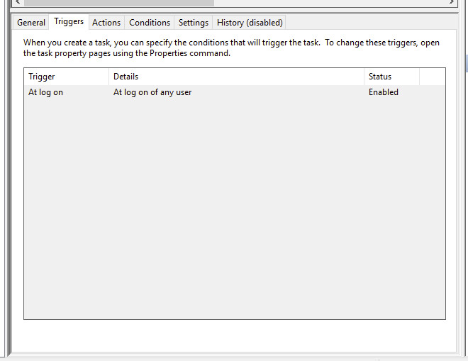

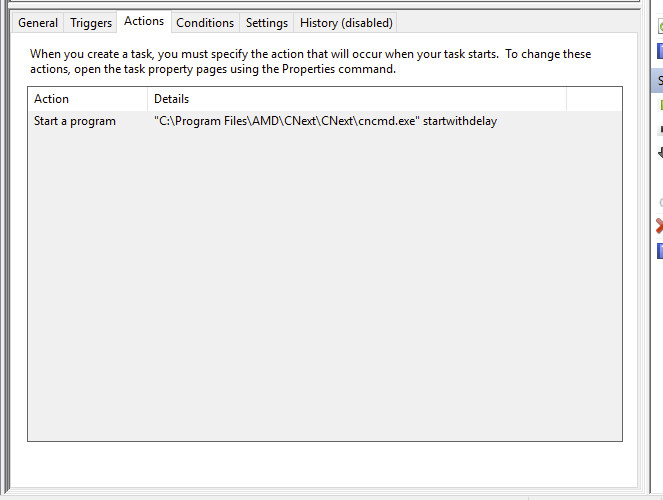

"RadeonSettings.exe" is Not a driver and it is the cached process. When a user starts the "RadeonSettings.exe" manually to change settings it speeds up loading of UI part of the software.
>>Looks like AMD is doing things differently and just pre-loads Radeon Settings in the background every time your system is
>>booted and a user logs in, no matter if AMD graphics hardware is installed or not. It would be trivial to add a check
>>"If no AMD hardware found, then exit immediately", but ok. Also, do we really need six entries in Task Scheduler?
It is a well known issue! AMD is one of the companies that secretly (!) creates an entry in Windows Task Scheduler to load "RadeonSettings.exe" every time a Windows OS starts. It actually violates your privacy.
A solution is very simple: Disable it in Windows Task Scheduler or delete. Personally, I disable it and check regularly that it is Not enabled again.
