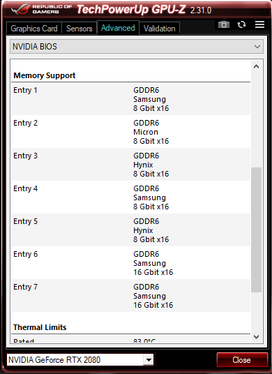

When looking up the type of memory that is soldered on my card, it tells me its exclusivly Samsung.
But when i click on Advanced, and then on NVIDIA Bios, it shows me different memory types on multiple entrys (Micron, Samsung, Hynix)
My question is if i can be really certain that theres just Samsung chips soldered on my card or if its just a mish-mash of chips from different manufacturers.
Im fairly new to all of this and GPU-Z aswell, i would really appreciate a explanation of some sort.
Thank you.
Manufacturers have several models of a graphics card, some with different memory types, if you see a GPU Bios with more than one memory type it just means that whether your particular card has Samsung or Hynix it's supported on that Bios, manufacturers don't mix memory types on the same PCB, the card wouldn't work because each memory type has different specs...……. some cards of the exact same model also have different revisions, those revisions may have different memory, this saves having to completely re-write Bioses… nothing to worry about, perfectly normal.
Keyword in your screenshot above is "support" that does not mean "using".
Thank you very much for the explanation Tatty_One! That means the bios is supporting all of the named chips, yet on my card are only samsung ones. Got it!
