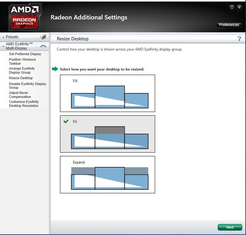

You have a lot of options in advanced configurations for eyefnity so that you can choose and configure easy anything that you prefer for example resize desktop:
maybe you will need some time to figure all of it....maybe sometimes it will not work perfectly at first then you going to need to repeat procedure and get frustrated but in general when you figure all out triple monitor setup from my experience is way better on AMD cards....When I am using 4480x1080(sometimes is even higher res. with bazel correction)on my side panels top and bottom image just a bit is missing and you can tweak&adjust your monitor position in settings.....atm I prefer using 4620x1024 with bazel correction so nothing is missing......Also as I remember on Nvidia cards I could use nvidia surround but then I could have only some silly res.(something like 3820x1024)so in that case is better to use programs like Windowed Borderless Gaming and force res like 4480x1080 in your games....It was working good only problem was no bazel correction options....
