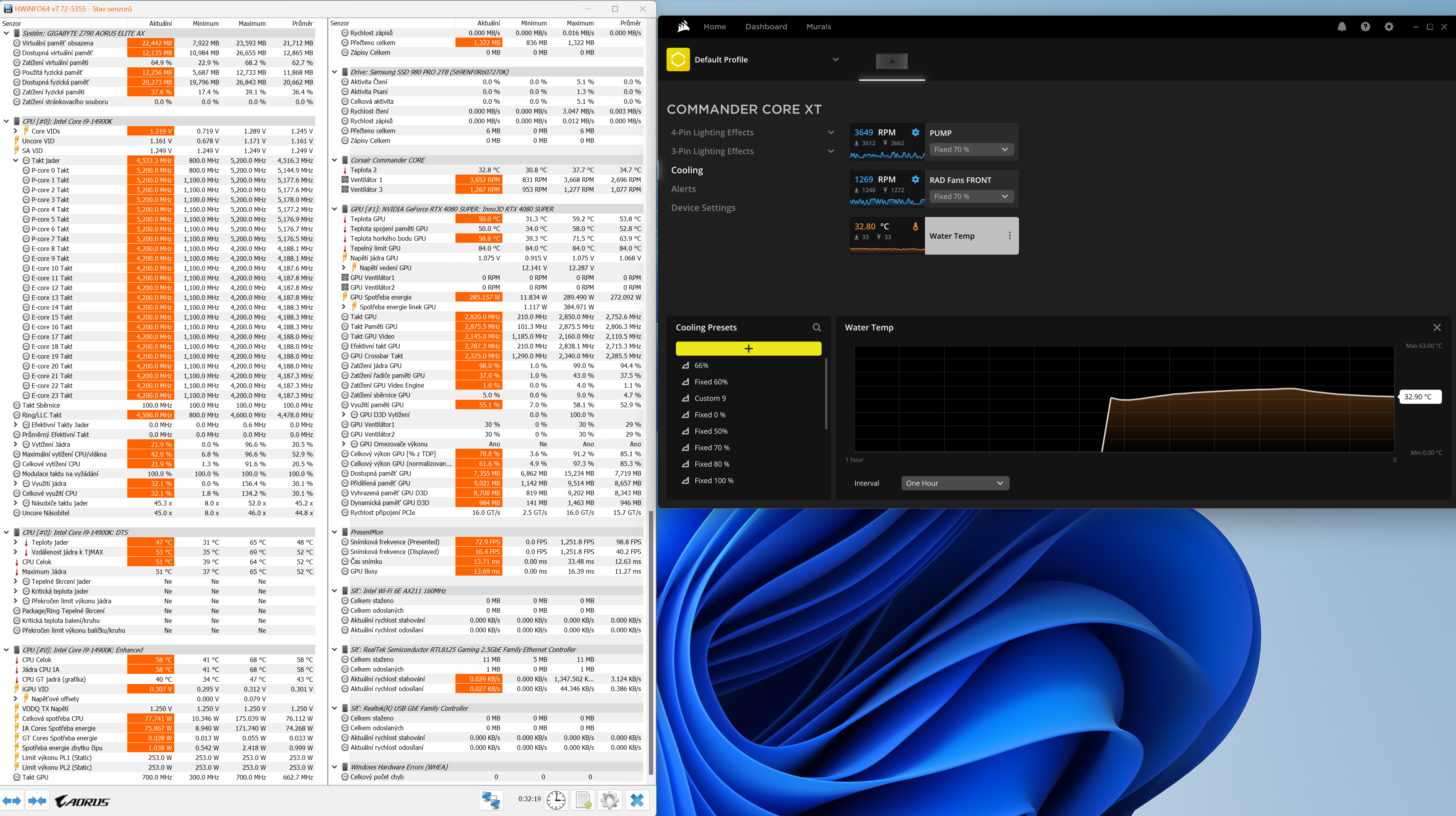

I tried running the top rad alone exhausting air:
It can handle the heat load 360W, unfortunatelly the GPU temperatures are alredy approaching the temps of good air coolers. Fans at 80% are pretty loud too. I believe this would stabilise as well with fans and pump both at 70%.
Then I added the front rad to the top one, fans and pump at 100, 70 and 50%:
and measured the same with the front rad alone:
The results from above screenshots, compared to my radiator bench measurements:
The 280 rad behaved almost the same as I measured it out of the system on the bench with my water cooldown method, however the rad combination with fans at 100% was cca 25% worse than they performed when they were on the bench, possibly due to the top rad exhausting air using the warm air from the front rad.
You can also see what the PWM rating of the fans and pump corresponds well with the loss of the cooling performance.
