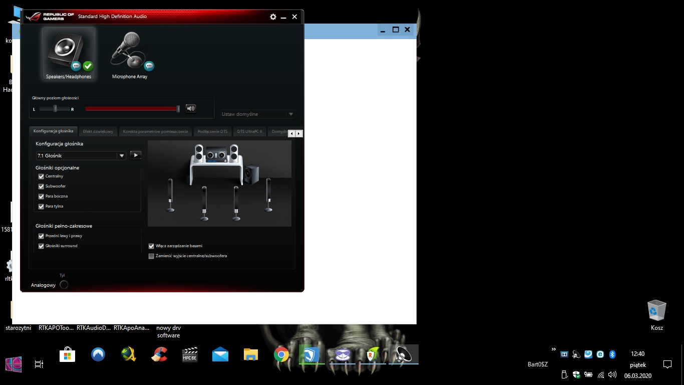

I have ROG MAXIMUS IX FORMULA and using Logitech Z906 5.1 1000w do you recomend this mod instead ok realtek uwp + sonic studio 3 ?
I recommend this mod to you. If you use optical output, look at the "HOW TO ACTIVATE DOLBY DIGITAL LIVE" and "HOW TO ACTIVATE DTS INTERACTIVE" spoilers. If you use the standard P2 (3.5 mm), you will have the option to activate the 5.1 speaker mode in the analog audio settings.

Is there any actions I could take in order to enable 5.1 digital output on my computer? I'm almost giving up.
Thanks again!
I ended uninstalling your mod drives, because it wasn't working at all (even as 2 channels output). In order to have s-pdif output working again, I had to install the drives provided by Gigabyte.

ya I dont understand why the drivers only shows 2 speakers instead of Dolby Digital (5.1) for my mobo as well. I dont know how to fix it
Nov 23, 2019
29 (0.02/day)
Analog: it shows 5.1/7.1 Digital (S/PDIF) it will alsways shows Stereo, it is normal! because ur AVR is the main device for settings, not longer windows!
