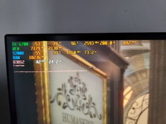

even in winter with 18c ambient. my 6950XT can stay at around 90-95°C for maybe 10 minutes until it starts to hit 110-113°C and throttles.
same for my 5700XT (when overclocked), 6800XT Aorus Master, 6900XT Speedster and 6900XT Nitro+. all are at least hitting 100°C on the hotspot after a while. the Nitro + and 6950XT hits 113°C even at 100% fanspeed with a 40°C delta after three repastes.

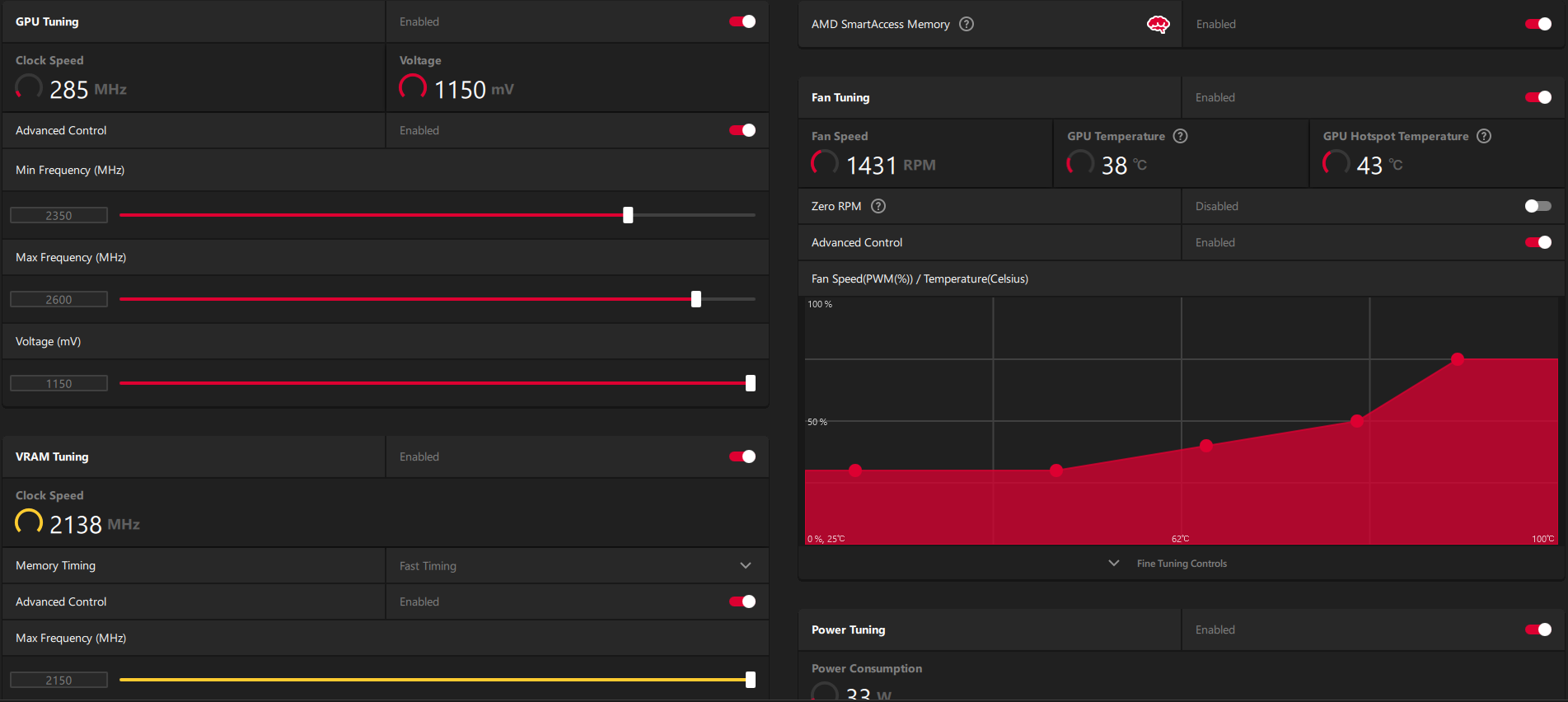

Thanks alot guys for fantastic answers I will try under volt and post the result

You could take it apart once more and this time be very careful to screw the heatsink back in as evenly as possible, go in a diagonal X pattern and in each corner you only twist the screwdriver by the same amount, over and over until completely tightened. If it's still just as bad as this I bet the heatsink just sucks and the cold plate isn't very even, once again gigabyte cards seem to be worse of them all.
Definitely undervolt, it will lower temperatures and increase performance.

I am aware of that. But if I put off the overclock and stick to stock clocks I'm down to 75 °C on the hotspot and 60 °C on the GPU so that's not it I believe.

nd overclocking, I never go above 90 °C hotspot with approx. 2500-2600 RPM on the fans
Choosing fan level is not working it keep raising despite what I choose.

Do you get these high temperatures during gaming regularly, or do you run a benchamark like Time Spy, or Furmark? Furmark is a GPU killer, don't use it.

Cannot screenshot it, so have a picture of it drawing 200W, which is the max power limit I set this time around.
The clock is still not reaching what it should (2660MHz effective, 2710 set on software), so it could draw even more
Using up to your power limit and killing your GPU with a highly unbalanced load are not the same thing. Time Spy is aggressive on power, but not dangerous with a properly configured GPU, or one running at default settings (unless it's defective). Furmark can be dangerous even with default settings.
