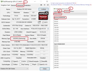

First of all please make some pictures : GPU-z main screen, GPU-z advanced tab with memory info, stickers from the card.
