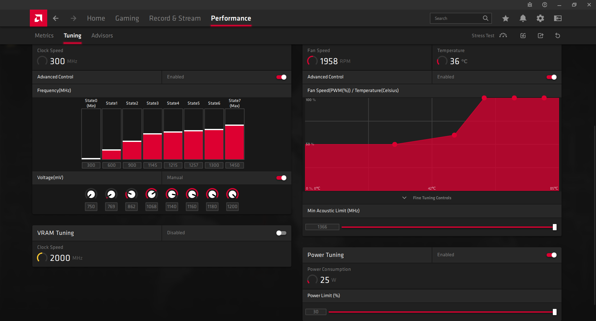

I have an RX 580 that I've recently overclocked.
- Overclocked Core Clock = 1450MHZ @ 1200mV
- Default Core Clock = 1366MHz @ 1150mV
- VRAM Clock = 2000MHz
I tried adjusting the VRAM clock speed in 50MHz increments. Made it up to 2150 but any increase in memory clock speed caused a decrease in gaming performance. Lower FPS.
I was wondering if adjusting the memory timings with something like 'AMD Memory Tweaker' would further enhance the in game performance of my card? If so is there any guide on how to do it? I dont have any experience with doing any of this but have read that some people tweak the timings and get more FPS.
Any help is appreciated. Thanks

Thanks for that info. I keep a temp overlay while gaming and with my overclock my highest temp is 78 c. Thats within the 'safe range', from what Ive seen.

So I can't overclock? I'm using the AMD Radeon software that comes with built in limits that are supposed to make damaging the card nearly impossible.

Take a GPU-Z Screenshot please so I can determine what you are running

@jdavid27 Has your 580 got Polaris 20 XTX core or XTR core? If XTX, I don't think it can go too high like 1450 MHz. Most 580 models that are rated higher than 1411 MHz have XTR version core. And though 590 has the same spec as 580, it uses 12 nm process so has higher frequencies.
During my overclocking, I also observed some weird things which are hard to explain. Just like yours, if it went too high, it just didn't perform well. I don't know why, temperature is good, display output is good, everything is good, but it just doesn't perform well.
Oh, maybe it is because the TDP limit. You see you gave it 1200 mV which is A LOT, so power I estimate could be close to 185 W. And even if you increase TDP limit to its maximum, it may fall down because of the capability of the model's power supply.

@RidiculousOwO - My RX 580 is Polaris20XTX. I played Call of Duty Modern Warfare multiplayer most of yesterday with those overclock settings. I had to have the fan speed kick in at 100% at 60c - 70c. This kept the temp at a max of 79c when under the heaviest load. I did see a significant increase in FPS with those core clock settings but the moment I touched the memory settings I lost FPS. I also did notice that my in game core clock would bounce around a little on certain maps. Only a couple of them did that though.
Then it may be memory taking up too much power. Polaris cards' memory has an "almost constant" power consumption which hovers round 30 W, and that is counted into Total Board Power (TBP), which includes core power as well as memory's.
In your case, since touching memory settings lost you framerates, why not leave it there? lol And 256-bit GDDR5 at 2000 MHz provides bandwidth of 256 GB/s which is enough.

After more testing I've set my overclock back to a Core Clock of 1411MHz @ 1095mV. Similar setting to @RidiculousOwO. Left memory alone because there is no improvment when touching it. Just more in game freezes and higher temp. For some reason when my card reaches anything past 75c it automatically downclocks like @impero suggested. I thought that would happen at a higher temp but that isnt the case with my setup for whatever reason. With my current setting I'm able to play COD Modern Warfare Mutiplayer with the highest temp only reaching 74c. Another random thing I noticed is that COD Warzone can run at 1450MHz @ 1200mV without the card ever going over 72c. I get much better performance at those settings without any downclocking happening. Thought that was weird but I guess its just a better coded game or something.
