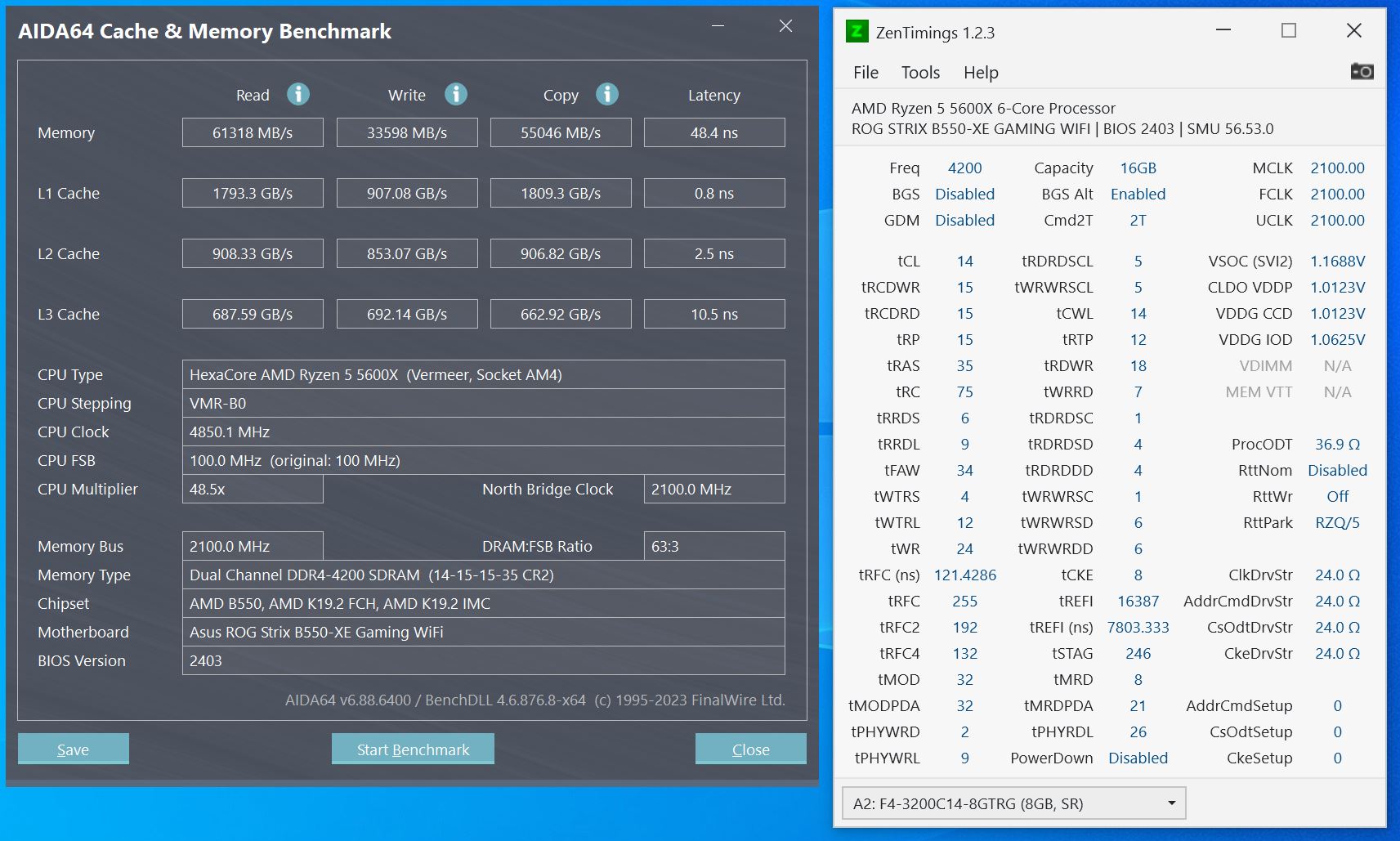

I have a 5600X that is stable at 2K 1:1, and can bench at 2100 1:1.

Like my 5600X.. you got a good sample, not all of them can do that.
