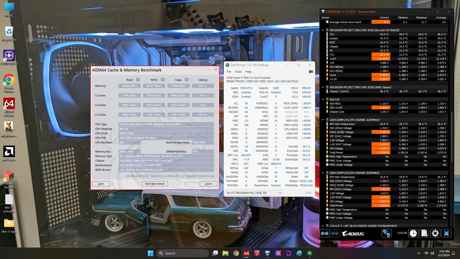

I just got this pc back together and threw this memory in to see if it would even boot. I'll fiddle with it soon. :)
Gotcha.
It made a difference. :toast: It does have a lot of errors in OCCT stability test though. Nothing in Linpack so far.

VPP: 1.85v? 1.8v is what this is normally at.
VDD: 1.4v - May need a bit more ~ 1.43 - 1.45 perhaps.
VDDQ/IO - May need adjusting, probably lower, I would try something like 1.30 - 1.35v
VSOC - Needs to be 1.3v? 1.2v doesn’t work? If 1.20 works you may could run something like 2133 - 2200 FCLK. Or something like 2067- 2167 if 1.25v is needed.
If nothing works tCRD 35 may need to be 36.
Doubt tRAS 30 is an issue but if so bump it up by 2 to 32, etc.
tRC 32 may be a bit low, 34 is lowest mine post.

No errors with these settings -
Nice improvement!
If you'd like it a bit quicker, I'd suggest trying the following:
tRRDS: 4
tRRDL: 8
tFAW: 20
tWTRS: 4
TWR: 48
tWRWRSCL: 8
tRP: 12
tRDWR: 14-16
tWRRD: 2-4
tRDRDSD: 8
tWRWRSD: 8
Do you need 1.3v VSOC for stability? You could be a fair bit quicker / better bandwidth if you could manually lower that to run higher FCLK.
I have little doubt you could be in the ~ 55-58ns range, perhaps a bit better.
Regardless as of now you're better than EXPO and stable so it's up to you :)

I've applied all those figures and it's been about fifteen minutes so far with no boot. I'll give it just a bit longer to be sure.
Interesting.
The settings I suggested aren't all that aggressive (especially for 6000 MT/s), they generally work for Hynix Adie.
Maybe its voltage related.
Or perhaps disable MCR (Memory Context Restore) / Power Down if you haven't already. Should improve your latency a bit as well.
If it doesn't boot you might have to Clear CMOS.

I'll go back into bios and check. The only voltage figure I changed this last go was VSOC to 1.2v...maybe put that back and retry first?
I did have to clear CMOS. Re-applied all figures (forgot TWR and tRP :rolleyes:), put the SOC voltage back to 1.3 and it booted. Perhaps I need to slow down and concentrate on one value at a time and test.
Perhaps 1.20v VSOC is too low but 1.25v VSOC may work and FCLK to 2066-2100.
This is just what I'd try personally.
I've done a TON of clear CMOS trying to get stuff optimized lol. This stuff can be a headache for sure but there's really no other way that I'm aware of, just trial and error.

I just now went back into bios and didn't follow my own advice...made two changes at once (TWR and tRP) and it won't boot. Let me figure out the offender and I will lower that voltage again.
Edit: Took tRP out of the mix and it booted. I'll try lowering that SOC voltage now.
Edit: It took the SOC voltage to 1.2v and booted. :toast: No errors reported.
FCLK 2100
