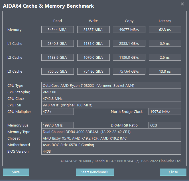

Slightly better without some background programs I managed to get 66Gb/s Read, 67Gb/s Write, almost 61Gb/s Copy and 48.7ns. Do you think I can improve further and do you think it's a good result?

You can probably go higher with loosened timings. Cezanne is very interesting, not only because it is a unified 7nm SOC, but because when AMD designed them for laptops they came with advertised DDR4L-4266 support out of the box. I doubt anyone has actually ever seen such a configuration on a laptop, but supposedly it was purposely built for such.

I believe you could try CL17 + CR1 mode and RFC 260-270 ns.

I didn't tight RFC yet, anyway this is c-die...so i cannot tight it too much like those b-die sticks :). maybe a little bit. about primaries, i'll test C17 and run TM5 for errors. thanks a lot!
