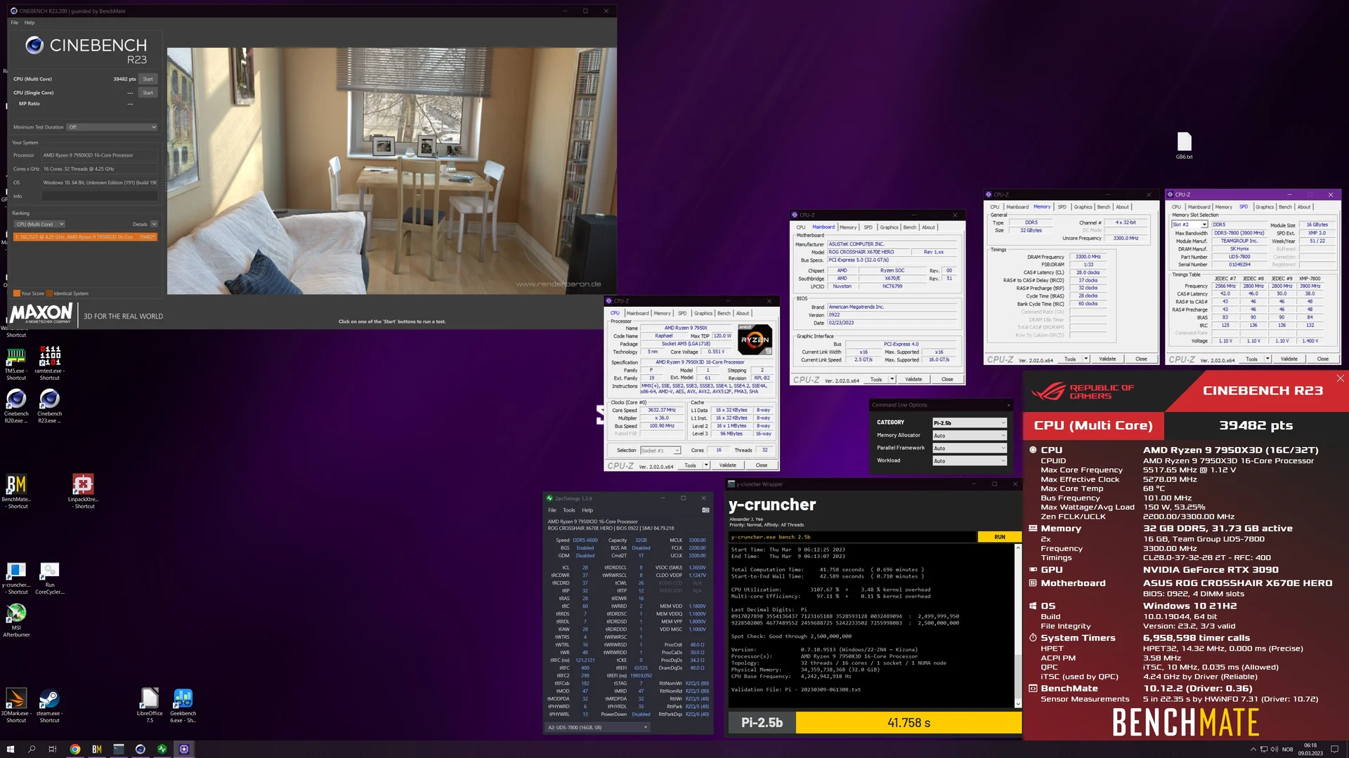

What is happening here?? Looks like Teamgroup 7800 memory downclocked to 6600? The timings look great. On a 7950X3D... Is it stable?
Doesn't seem to add up, theoretical limit is 6600MT/s*8*2 = 105.6GB/s , where is the extra 38.42GB/s coming from?
