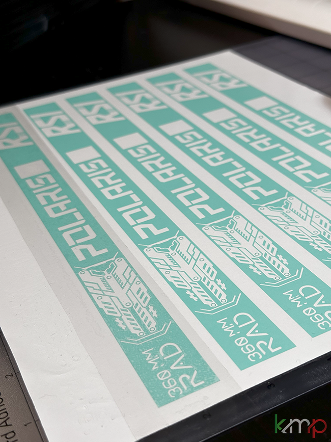

I’ve started working on the aesthetic side of the mod, experimenting with custom stencils and graphics for component detailing. For this, I dusted off my trusty old Silhouette Cameo 2 – outdated, yes, but still getting the job done like a champ!
In the pics you’ll see:
  • ✂️ Vinyl cutting in progress
  • Manual weeding with precision knives
  • First test application on a radiator surface
I designed graphics inspired by the RSI Polaris, including:
  • "POLARIS – Danger Engine"
  • "RSI"
  • "RAD X 360MM"
  • and more tech-styled visuals to replicate the vibe of a real starship subsystem.
It’s still an experimental phase, but so far I’m happy:
"Clean details, good vinyl grip – a solid start for the upcoming airbrush stage."
Got suggestions for other decals, logos, or phrases? I’d love to hear your ideas below!

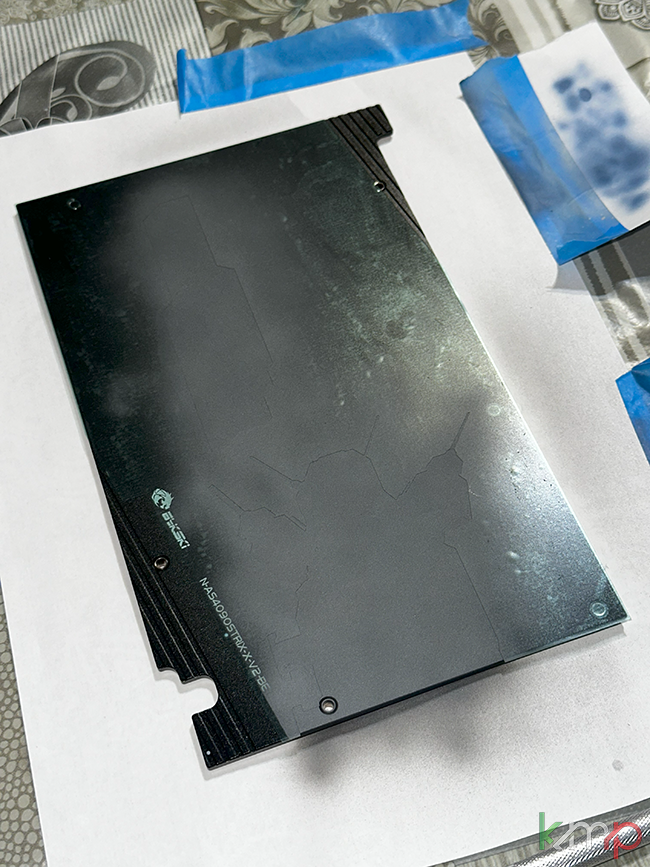

Radiator Stencil & Paint Test
Today I started the first stencil painting test on one of the radiators.
The goal of this phase is to evaluate:
  • stencil hold during application and painting
  • edge sharpness after removal
  • readability of small graphics
  • behavior of the paint on a clean, untreated metal surface
Materials and tools used:​
  • Metallic silver acrylic paint
  • Custom-cut adhesive vinyl stencils
  • Airbrush with a 0.3 mm nozzle (low pressure)
  • Masking tape for isolated protection
The radiator was cleaned thoroughly, but no primer or sanding was applied.
Application method:​
After placing the stencil and masking the surroundings, I sprayed a few light, crossed passes with the airbrush, letting it dry between layers.
Once the paint was dry to the touch, I carefully removed the stencil to evaluate:
  • whether the edges remained sharp
  • if the small text was still legible
  • whether the vinyl held firmly or lifted during the process
Precision and challenge:​
The details in this test are as small as 0.6 mm – extremely fine.
Getting clean results with such small elements is not easy, especially using non-professional tools and being still quite new to airbrushing.
But challenges like these don’t scare me – let’s see how it turns out!

Hey everyone!
Sorry for the silence these past few days – I had a small surgery (nothing serious!), but recovery slowed me down a bit.
Still, I’ve kept working on the build when possible, just at a slower pace.
Specifically, I tested the first airbrush paint on one of the radiators, as shown in my previous post, using vinyl paper cut with the Silhouette Cameo as stencil.
As expected, that material isn’t meant for this purpose, and some of the fine details were torn away during peeling, which compromised part of the result.
That said, the test was very useful to understand:
  • how the stencil behaves on slightly curved surfaces
  • how well the edges hold up during spraying
  • how vinyl adheres to untreated surfaces
I’ve therefore decided to completely remake the graphics, improving proportions, detailing, and composition structure.
✅ I also purchased the proper stencil masking paper, far more resistant to tearing, with better grip and control – much more suitable for this kind of work.
The images show:
  • the final digital layout of the updated graphics
  • the precise cut using the new paper
  • the application on the radiator, ready for a new paint session
I’ll share the final result as soon as I can.
In the meantime, if you have suggestions on materials or techniques for handling ultra-fine details (some parts are less than 1 mm thick!), I’m all ears.
Thanks to everyone supporting this Star Citizen-themed mod!

You are doing astounding art here (I don't want to associate the word work :P).
We need to talk about your paint viscosity and air pressure though....
What I am seeing on your spraywork is suggestive of poor atomisation or lack of pigment emulsification.
Different colours are actually different to spray because of the pigment and white is the worst...always.
The general approach I would suggest testing on another hard surface (specifically hard surface not cardboard or absorbable) is the following:
Viscosity / air pressure / distance are what you use to control spray quality...
a thin low pressure up close for super fine lines if pushed too hard with too thin or too high pressure will fish-eye (insufficient pigment), or blow around (air pressure).
a thick paint with insufficient pressure will not atomise correctly and will look spotty.
Spray too far away and your paint will dry before impact and look powdery.
Can you see the combination of these factors in play? It's infinitely variable *within the capacity of the paint and your airbrush*.
Some basic guidelines I suggest for comparing to your current results:
1. Paint well shaken and mixed with reducer to appropriate consistency. Even paint able to be sprayed out of the bottle can be improved with reducer to get pigment to emulsify properly (so leave it for about 15 min after mixing) and often will flow MUCH better at reasonable air pressure.
2. The distance you paint is going to be controlled by nozzle size because the paint is in a circle not a fan, and naturally a smaller area than a spraygun style paint tool. A fine nozzle needs to be closer or slower moving.
3. Adjust air pressure so you are getting finely atomised paint that flows cleanly and hits the target wet.
A guide to air pressure is often available with the paint in online manufacturer guides.
4. Trigger control, angle and distance are the art of airbrushing. For general stencil work wanting even coverage spray past the area in overlapping strokes - this avoids hot spots from pausing.
Learn to be able to turn off hte paint with the trigger while keeping air flowing.
An exercise for this is 2 vertical lines about 10 cm apart. Starting before one line you want to spray accurate straight lines to make a ladder. Keep the air on and start/stop the paint at the veritcal lines - no overlap and no short stops. It's pretty hard to do initially but helps you develop trigger "feel".
Createx have some amazing tutorials online. If you can search for their airbrush tutorials not so much the spraygun ones you will get a TONNE of info that has helped so many people.
Also Drew Blair... he is one of the foremost airbrush artists in the world and publishes a lot. He is more a photographic artist but the skills are all the same.
Hi!
Thank you so much for the time and care you put into this reply — it’s immediately clear you speak from direct experience and deep passion.
I have to admit that some of the issues you described actually showed up during my first paint passes, but I wasn’t sure whether it was a matter of pressure, distance, or dilution... Now it all makes a lot more sense. Your explanation about viscosity and pigment emulsification was really enlightening, and the note about how different colors behave — especially white — completely resonates with what I’ve seen!
I truly appreciate the practical advice too: I’ll definitely try the parallel line exercise, and start working more on trigger control — that’s where I feel I have the most room for improvement.
I’m also saving your reference to Drew Blair and the Createx tutorials — I’m sure I’ll learn a lot from those.
Thanks again for your support, it really means a lot
One of the best parts of sharing projects like this is getting feedback from people like you, who offer concrete and helpful suggestions with a constructive spirit.
New preview from the Star Citizen-themed mod – Custom GPU Backplate!​
Hi everyone!
I’d like to share a new preview from my ongoing Star Citizen-themed PC mod.
This time, it’s all about the custom GPU backplate, entirely designed from scratch in AutoCAD, and now ready for paint using handmade stencil masks.
Key elements of the design:​
SQUADRON 42
At the top left, the logo of Squadron 42, the iconic single-player campaign from Star Citizen. It’s a tribute to the narrative and military core of the universe, as well as to my personal love for immersive, technical aesthetics.
RSI POLARIS SILHOUETTE
On the right side, the full silhouette of the RSI Polaris, the main inspiration for this mod. The shape was manually vectorized to preserve its proportions, with a stealth-like, functional design approach.
RTX 4090
The powerhouse of the build: the GeForce RTX 4090. The badge-style graphic features futuristic tech lines, fully aligned with the RSI style and Star Citizen’s industrial design language.
MADE IN ITALY
A personal touch I couldn’t leave out: the Italian tricolor at the bottom highlights the origin of the project, the craftsmanship behind it, and the passion for detail that defines Italian creativity.
Technique and process:​
All elements were created in AutoCAD 2D, then exported as stencil cut files to apply layers of paint via airbrush on pre-treated surfaces. This technique ensures sharp edges, long-lasting adhesion, and seamless integration with the overall theme of the mod.
I’ll soon share updates on the painting process and final assembly!
As always, any feedback or suggestions are very welcome.
Thanks a lot for following and supporting this journey!

First Layer Done! | Star Citizen Mod – RTX 4090​
The first coat of paint has been applied to the backplate, using the stencils designed in AutoCAD.
This was a delicate step, carried out with airbrush and precision masking, to begin bringing the Squadron 42 and Polaris-inspired design to life.
The Italian flag proudly seals the work — a tribute to Made in Italy modding.
In the upcoming stages, we’ll move forward with additional layers, shading, and final detailing.
The project is progressing, and the vision is starting to take shape!
