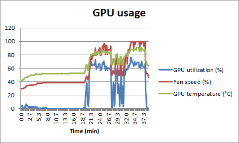

I use GPU-Z mainly to log data from my GPU to analyze it. I think there's something wrong with the readings I'm getting now.
This the graph from GPU-Z provided data when I play Rocket League:
Meanwhile I monitored the reading from Task Manager at the same time. There the readings were 50%-ish all the time. Other readings matched with HWMonitor, like temperatures and fan speeds.
Is GPU-Z's GPU load different than Windows Task Manager's GPU's utilization and HWMonitor's GPU Utilization or is there a problem, and how to solve it?

Time-data is done by me (+10sec, as set in GPU-Z also) just so I get to make the graph easier.
As you can see, GPU-Z is mainly giving 0 or 100 values.
Here are my GPU-Z sensor settings
It simply can't be right. There's a 2 minutes long 0% load period during gaming. I've tried with 0.1 sec refresh rate also, results are similiar.

I wouldn't trust the memory controller load either. Memory Used (Dedicated), which is third column from right, shows that there is over 1GB VRAM being used during that session (from 2 to 4 minutes) and I was in-game the whole time.
To clarify what I'm after here, I would like GPU-Z to log the % of maximum potential performance used, like Windows Task Manager does it. But the "GPU Load" readings aren't indicating that at all. Are they supposed to, is it broken, or is there not any way to do it as I want?
There is a similar issue with polaris cards, in hwinfo you will have "Utilisation" and "D3D usage" Task manager reports the latter, which works afaik. The former goes up down up down up down up down on my 570 like a yoyo. not had the issue on vega, but i cant remember if i did on any hawaii cards i owned.
I got the GPU utilization, which seems to be the D3D Usage that I wanted, from HWiNFO. I'm not sure if my temps are as good as they should be, around 90 degrees Celsius on around 70% utilization. (Battlefield 4 ultra graphics 1080p with vsync 60Hz on)
