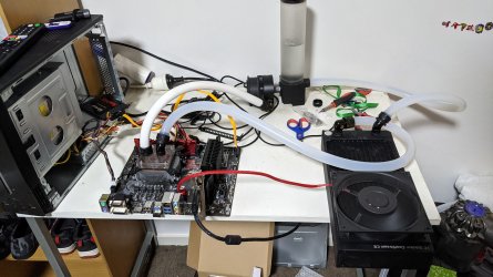

Full on teardown, treat like a new build... BIOS flash and reset, re-seat all components, take it out of the case and test on its cardboard box, etc
This is the janky ass build i'm using to run memtest on RAM at the moment, just to rule out the mobo or IMC being an issue (its suuuupper ghetto, but all parts are confirmed stable)
