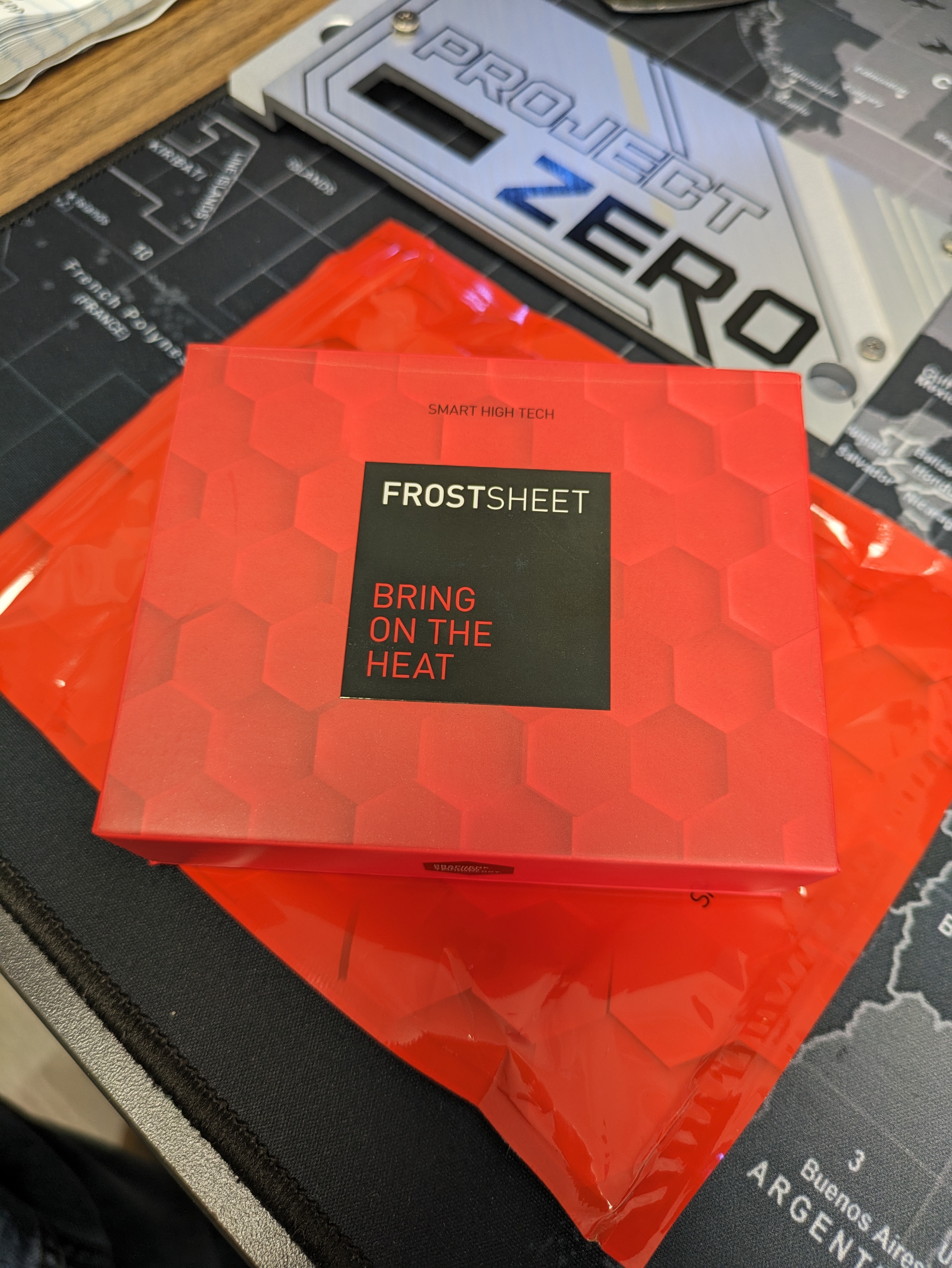

Ordered some FrostSheet the other day and just now realized it is coming from Sweden...can't even read the tracking. :laugh:

FrostSheet from Sweden...
PXL_20240226_220703970.jpg PXL_20240226_220902997.jpg PXL_20240226_221010875.jpg
according to this review of it it reads exactly the same as mx-4 paste. you will never need to own paste again. rock on mate! for desktop rigs never need paste again. I am leaning towards kryosheet or frostsheet in my future too.
It appears to be working well on the 7900 atm. This pc being hard lined I'm hoping to never have a reason to lift the water block.
Just bought the FrostSheet myself - similar performance as the MX-6, at least for my 5800X3D, according to the Prime95 tests I did before and after.
yep, with frostsheet and kryosheet, there is no need for paste anymore imo unless you own a laptop.
Hmm i found no info if frostsheet is electrically conductive on their website like kryosheet is
Would be disappointing if it is which im assuming here and no warning/notice on the website
