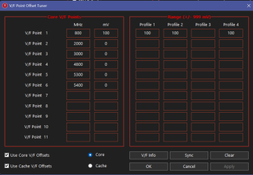

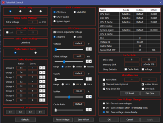

Legion 275hx 5090, COD only (so far) will stutter and crash even on default fresh install settings. Just having the app open will cause the system to hard lock. All other games tested so far working perfectly undervolted. The same undervolt also works fine on cod using XTU. Same on other legions with the same spec. Thanks.

If you are still having problems with ThrottleStop, show me your settings. Include screenshots of the main window, the FIVR and TPL windows, the V/F Point window and the Per Core window. Maybe I will see something in your settings that can be changed.

All sorted now, thanks for the help.
All sorted now
What did you need to do to fix the problem you were having?
I have seen a few people on Reddit using ThrottleStop 9.7.3 on their 275HX CPUs without any problems.
It’s was legion spaces xtu still running in the background. Yeah it’s been running well since. We just need nvidia to fix their driver gsync issue with some games and it should be all good.
