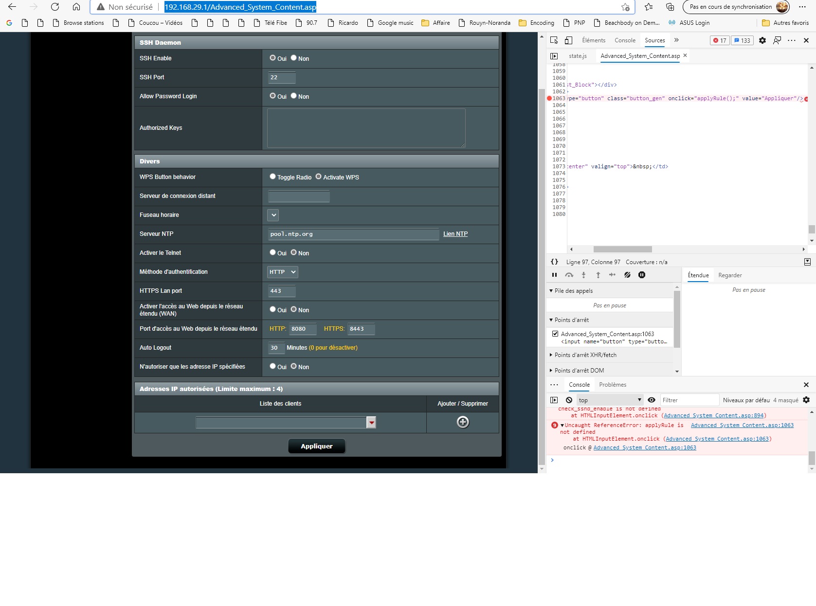

Hello Got a problem with my downgrade using the NO CFE USB Instructions. everything seemed to have work fine. but once everything got boot up again web gui was broken. i was able to get to the Advanced_System_Content.asp page. i can select the ssh but i cannot apply the change. page are broken. i cannot use the diagnose button anymore.
is there a way to send the command to the web gui to apply the change ?
Anything please
Old tm-ac1900 build was 3.0.0.4.376_3221 Anyone know where i could get that file. i still have acces to asus mini-cfe page but always get that it's not a valid file. maybe i'll try putting it back in.
well at that point i'll try anything. the thing ping and seem to partialy work but i don,t know to which extend
Update : i tryed to get to the firmware page looking to reflash it but i still have the same problem i can't it the button but at least i know a was succesful in a way to push a part of the firmware in

well done! i have four of these of which three converted with no issues. the fourth one is being difficult (probably me doing something wrong).
have a question though. something doesn't seem to work for me. when i enter the commands it seems like nothing is happening. please see attached file. can you please tell me what i can do to make it work? the 'hit enter, then click the diagnostics button' in your post confuses me. cant seem to find a diagnostics button.
(on a side note: current firmware is: 3.0.0.4.376_3199. i tried to use the CFE mini web recovery, everything seems to work but then i get an error saying something about invalid firmware).
thanks in advance!
