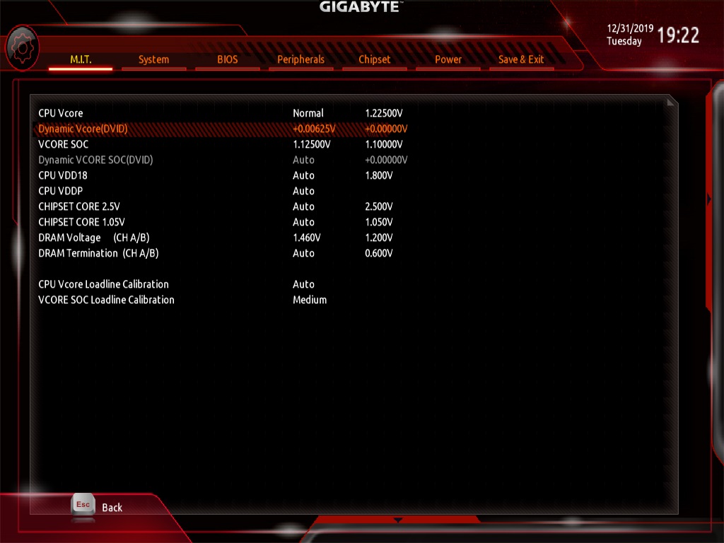

Yes, SVI2 TFN is reported by the CPU and is the most accurate. The other Vcore you'll see is reported by your board's ITE chip, and is not as useful. RM has been really glitchy in the past (there was this period of time when it would report Vcore as a constant 1.4V+ as long as you had the histogram display enabled in the application), so just use HWInfo.
I think I see the source of possible confusion here. Visually, all 400-series Gigabytes have the same BIOS (and even X570, just kinda reskinned and reshuffled here and there), but the pre-Matisse BIOS versions look a bit different to the post-Matisse release versions. I built a 2600 (Pinnacle) system for a friend with the exact same board as mine, but with an earlier BIOS (F4 or F5, I think), and he has things like EZ Overclock Tuner in BZ's video, which they seem to have taken away for Matisse, as it's not there in F42c, F42g, F50a and F50.
I'm guessing your F50 should like something like this? BZ's Pinnacle BIOS doesn't have a separate CPU Vcore field, which is helpful if you want to run fixed freq but also introduces the whole Normal/Auto headache. There used to be a functional difference between the two, not anymore it seems.
Whether you have anything to gain kinda depends on the chip you have, but that 1.481 Vcore peak is in line with stock highs on mine, though mine goes all the way up to 1.5V without any offset.
