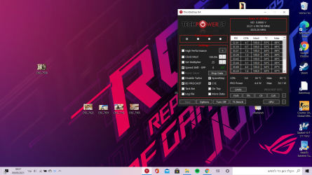

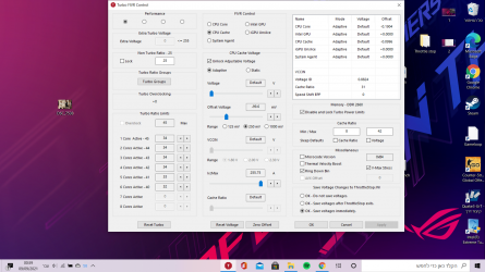

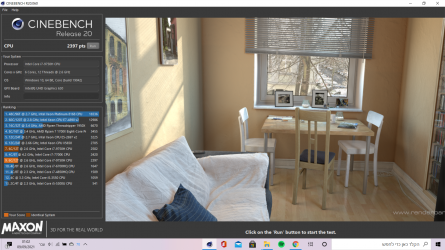

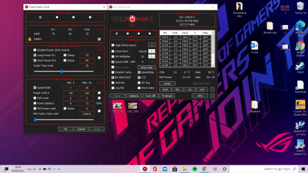

Hello!
I have an Asus ROG Strix G531GT I9750H with GTX1650, and 16 gigs of RAM.
I've been trying to undervolt my CPU as it reached high temps. Therefore i tried following the instructions on similar threads for this CPU but im not sure if they worked for me or not as i dont see that much has changed, the CPU still gets hot...
I'd like to get your tips on how to undervolt it the best way possible.
Im using ThrottleStop 9.4.
I've attached a few Screenshots with my TS settings and TS log with 20 minutes of CS:GO gaming on high settings and also Cinebench score.
Thanks in advance!

190mv undervolt ! Nice .
Have you recently cleaned heatsink fins ? Checked thermal paste if it’s still fresh ? Maybe use a better paste , and I hope that when you’re using the laptop the fan intakes are not blocked .

I think your temps are good and the score in CB20 is very good too. Just blow the dust out if you haven't done it yet. Lift the back of the laptop with something for better airflow and that's it. (I'm with G731GW).
A score of 2400 or 2500 in Cinebench R20 is terrible for a 9750H. When these CPUs are not thermal throttling or power limit throttling, they should easily be scoring over 3000 in R20.
@Jaked - You have lowered your 6 core active turbo ratio from 40 to 32. That drops CPU performance by 20%. That explains why your Cinebench score is so poor. Why not pull your laptop apart and fix the overheating issue? You are never going to get maximum performance out of your laptop if you are forced to slow it down so it does not run so hot. An undervolt is not a cure for thermal paste that needs to be replaced.

Attaching screenshots with my TS setting:
If you're hesitating for something or just need more help - let us know ;)
