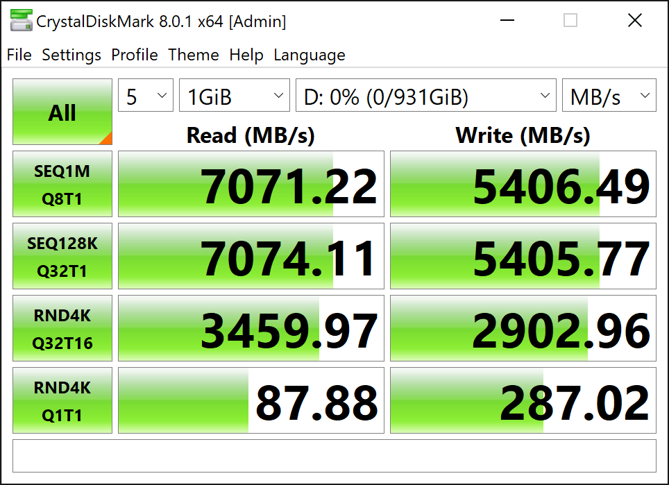

Just grabbed a new SN850 500GB myself and here's the CrystalDiskMark 1st run today.

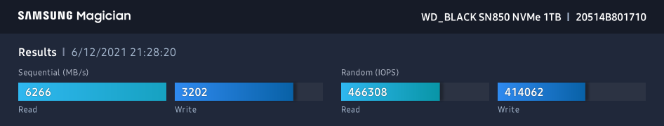

Hello! You'll have to forgive me I'm just an average user, but I've been interested in the on going discussion regarding these drives. I recently purchased an Aorus X570 master rev 1.2 MB specifically for the option of having 3 m.2 slots on the board. Great! I thought. However after noticing stuttering issues with a capture card I have and narrowing the issue down to the onboard WIFI adaptor causing the problem I thought there is perhaps the same thing causing an issue with the drive speed as i've got pretty similar results. the Issue causing the capture card to have reduced bandwidth is that the WIFI adaptor seems to be limiting the max payload on everytthing that uses the same bus ? (sorry this might be incorrect way of putting it) to 128 bytes. I've emailed Gigabyte to see what can be done because there isn't an option in the BIOS to disabled the adaptor and I can't remove it without taking off the plastic shroud thingy. So although I've read what the MB vendor in the other person(s) instance(s) and WD had to say I wonder is this is the case with my board at least, but also it might be something to check on your own board. I used a program called HWiNFO64. I'm sure all you tech experts have heard of it. Do you think this is a possible cause of the drive speed limitation ?

Just pulled out my intel wifi card, still getting crappy writes:
I do still see limitation to 128bit though on the chipset lanes dur to titan ridge thunderbolt controller:
Disabling Thunderbolt controller and I now get 256bit bus and SN85O writes have increased by 2gb/s to 5129 MB/s , so it seems SN850 needs that 256 bus or more to get max write speeds.
Well done @tallarnk for finding the root cause :)
oh that's brilliant, I'm so glad! I'm also bloody annoyed, how is the average user supposed to know that on purchase..oh btw some of your stuff won't work correctly. the only things that are mentioned clearly in the manual are the 2 end sata ports.
