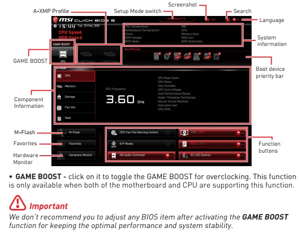

Do you have MSI CPU Game Boost enabled in the BIOS? Latest chipset drivers installed?
I do have the lastest chipset drivers, can you tell me, where I can find that MSI CPU boost option in the BIOS? I'll activate or deactivate it then (I think I shall activate it, right?) and try the standard limits for PPT etc
It's called Game Boost actually, edited my post. Never used it myself so no idea what it does, other than messing up manual settings. Should be disabled:
I see, never had it on. I guess I won‘t be using it too. My Power limits also were on disabled or had really high values, nothing really changed tho
