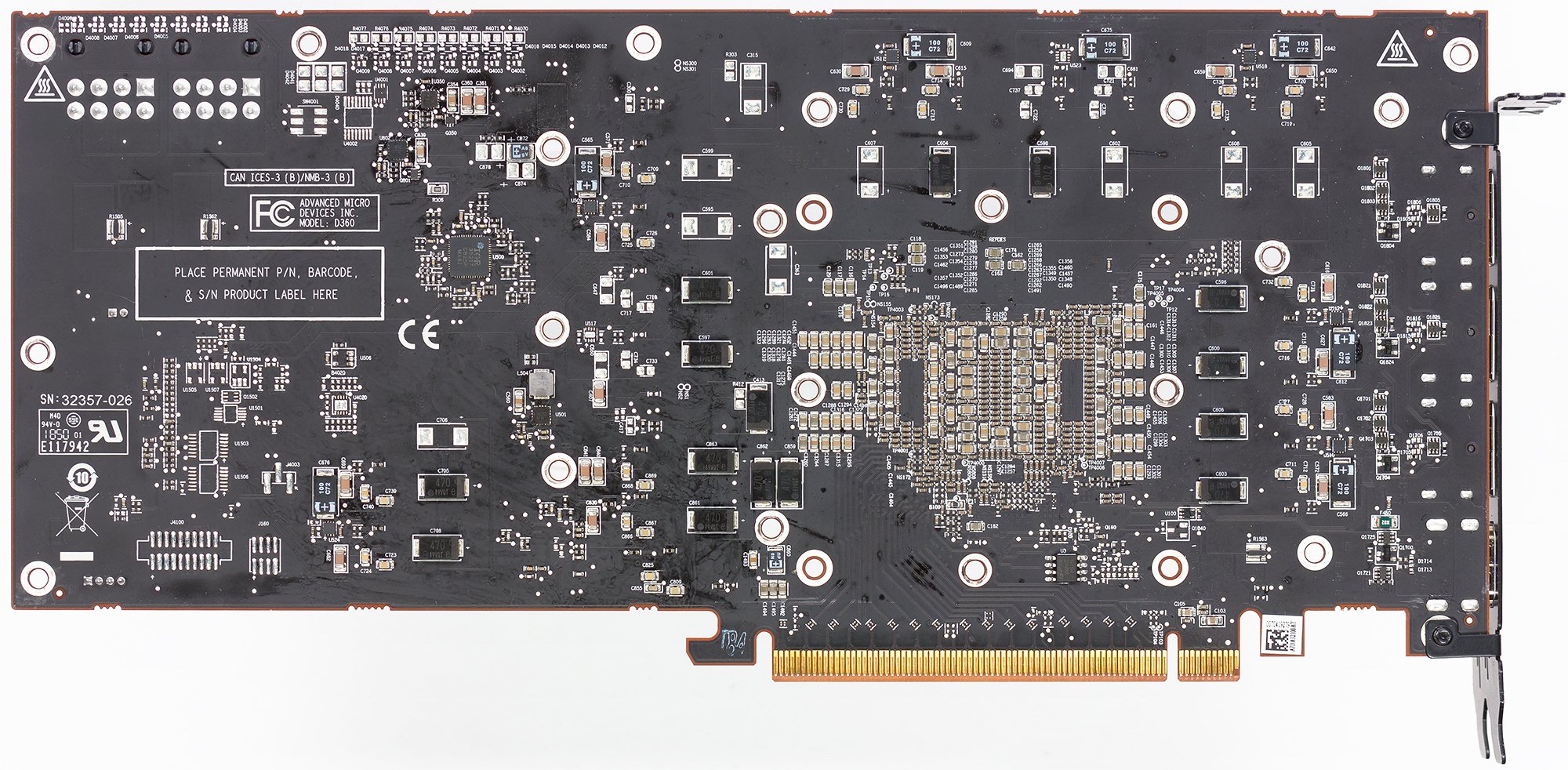

If anybody has Radeon VII , i request detailed photo with what bios it originaly has, and what memory (samsung or hynix) if we will collect just two cards with samsung and hynix, we might proceed with downgrading Samsung cards to lowest frequency and timings, with what hynix currently has. but i only have samsung card, so cant proceed with searching for straps or etc differences to work with (it might work, and, i guess it will not require special hacked drivers etc). actually if anybody wants to sell their cards like for 100$ i will buy it to make some insane sh*t, currently im in Minsk, Belarus. and have one
i have all special equipment required, included leaked amd linux-based tserver test for Radeon VII and others, including Vega.
if you have linux you can try
# lspci -v
if your card has no address to video memory, it means degraded card memory, and, i believe, there is a little chance, if it is Samsung chips to somewhat modify board straps or card bios.
But, as i said. has no material to work with.
PLEASE, IF YOU CAN. I BEG YOU TO MAKE HIGH QUALITY pictures of Vega VII from both sides

i will help, in case of receiving high quality pictures of them)) waiting for now.
