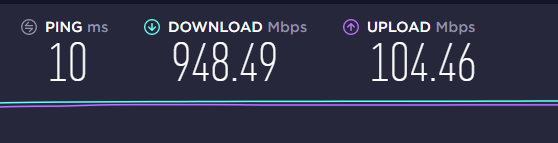

I think I'm gonna stop bitching about my speed, my laptop gives me 700-800mbit consistenly even when connected through a second gigabit switch, I'm fine with that speed, only issue and I wonder if you guys could help... is my tower on the same cable "test" 5e runs at a slower speed than my laptop, ¿might it be cause I updated to H2O?? gives me 320mbps avg. see videos if u want to ok?
Slowest speed is with my phenom tower, fastest with my icore laptop, both tests on windows 10.
By tower, do you mean your desktop PC? Did you try using the same exact cable as the one you plug into your laptop? Otherwise, it could be a limitation within your desktop PC such as your network card or something.

The numbers you're showing looks like you're trying to use a gigabit ethernet adapter over USB 2.0.

@Miguel2013, FTP is the worst way to test transfer speeds. iPerf3 would be my tool of choice, but I do have an advantage of having access to 2 work servers with dedicated 2Gbit channel each and located in two different exchange networks. Plus, I know my results won't be skewed by 100 people that are trying to test their speed on the same server.
Also, ISPs usually give an "up to" speed metric, which usually means it can be and will be lower.
Plus, speedtest is glitching out lately about picking the nearest server or even generating a list of servers. You might want to do it manually, or test your speed on several servers several times. Preferrably between 1:00 and 5:00 AM, when random people don't test their speed, and when your ISP is least loaded.
Could be a case of bandwidth cap for international traffic. For example, my ISP provides 1Gbit/s for Ukrainian traffic, and 300Mbit/s (which they bumped to 400 recently) for international. The only difference is that my ISP shows this upfront, and not in small print under contract.

What's your CPU usage while testing? Phenom platform is pretty old, Idk how well it offloads networking stuff.
How do i see it? With task manager?
