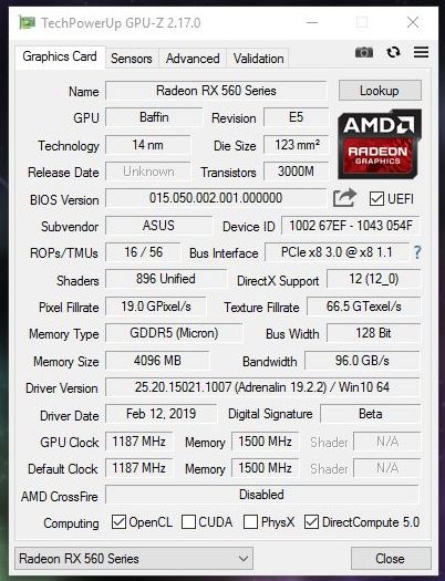

i tried it today and had some issues getting it to work, i couldent get radeon to install correctly after flashing that bios with ati utility and no 3d applications would run,
the rx560 was displayed as unknown device aftr flash and reboot, if i updated it in dev manager, it showed it as a rx560 with questionmark and the error 43~
in gpu-z the shaders show as 1024 but its missing some information in other areas.
i think i was getting display from the igpu instead of the rx560 so not sure if the bios file worked~
(i tried pixel clock patcher in case it would change something,(im not sure if i was supposed to but i didnt modify anything with polaris bios editor either; was i supposed to edit the hex or is this what you did allready with the bios file?) also where do i find polaris bios editor?
do i need to try something different here?

did you restart the pc after using the pixal clock patcher? the proper method is:
1.Flash the new bios
2. restart the pc
3. apply the pixel clock patcher
4. restart again
it looks like it did unlock just you need to follow the steps i showed above to get the drivers working.

o: ohshit it worked lol
thank you o:! gonna mess around some tests in next day

Gratz on the unlock. :toast:
you now have 14.2% more shading and texturing power per clock.
Use it wisely :3
